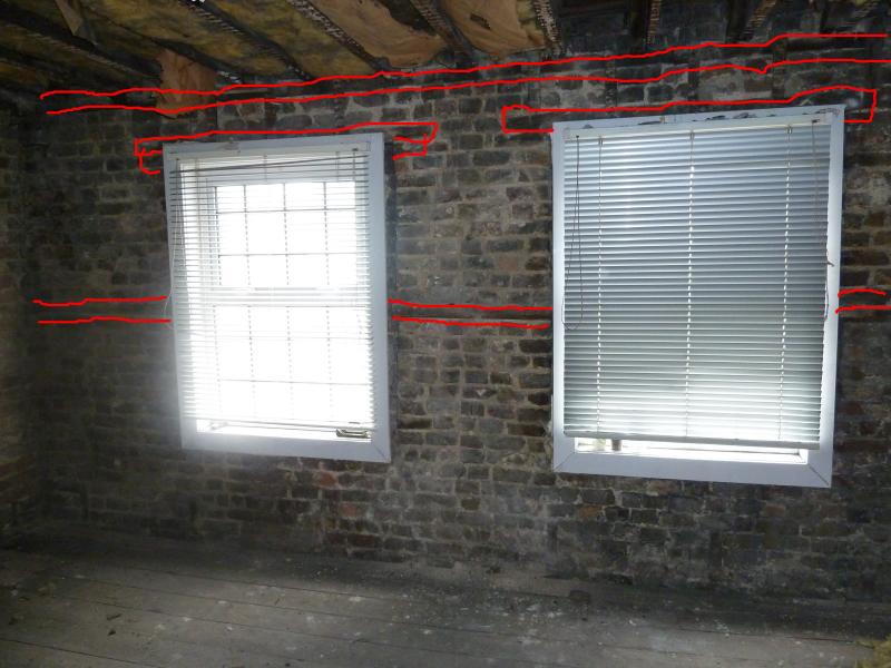

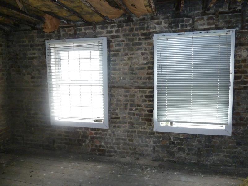

Here is an image of the front wall from the inside.
There is a lot of timber built into the wall, including the window lintels and the wall plate, where the rafters & joists meet the wall. There is also some timber built in around half way up the wall, which was used to fix timber battens to the wall for the laths. It is probably quite difficult to see in the photo, so I've highlighted the built in timber in this photo. (Well, I've tried to. My artwork leaves something to be desired)
The surveyors findings were
A softwood wallplate is built into the front wall, and this supports the ceiling rafters and the roof rafters as well as parapet gutter boarding.
Several ceiling rafters were found to be loose/detached, and some suffering wood rot.
Counting from right hand end, the following rafters have problems as indicated :
No 4 : rafter too thin
No 7 : loose at end and rot damaged
No 8 : end of rafter rotten.
No 10 : end of rafter rotten
No 13 : end of rafter rotten
Easiest to simply replace defective rafters complete as timber not unduly expensive.
The built-in wallplate is subject to rot, mainly at its base, at a number of locations.
In addition, The left hand window’s timber lintel is rotten on the top, with wooden end
bearing pads rot affected, and the right hand window’s left hand timber bearing pad has rot underneath.
There are horizontal timbers at mid height of the windows, and these members are also
damaged by wood rot.
So in effect all built in timbers need replacement.

The two top floor windows are plastic double glazed sliding sash type.
They have been rather lazily fitted. There are huge voids between the original brick recesses and the new frames. This in effect in my opinion weakens the window openings, as a traditional box frame would help brace up and support a brick opening. Brickwork at this level has a noticeable bow and must in my opinion be tied in.

b) Front Elevation bowing – Window openings need bracing up. You might opt, for example, to take out the two top floor windows and if finances allow – replace with traditional box frames.

Perhaps you could post pics of the front elevation and redline the area with the bulge(s)? And maybe do a similar pic from the interior?
Sure, I will do that in the next day or two.

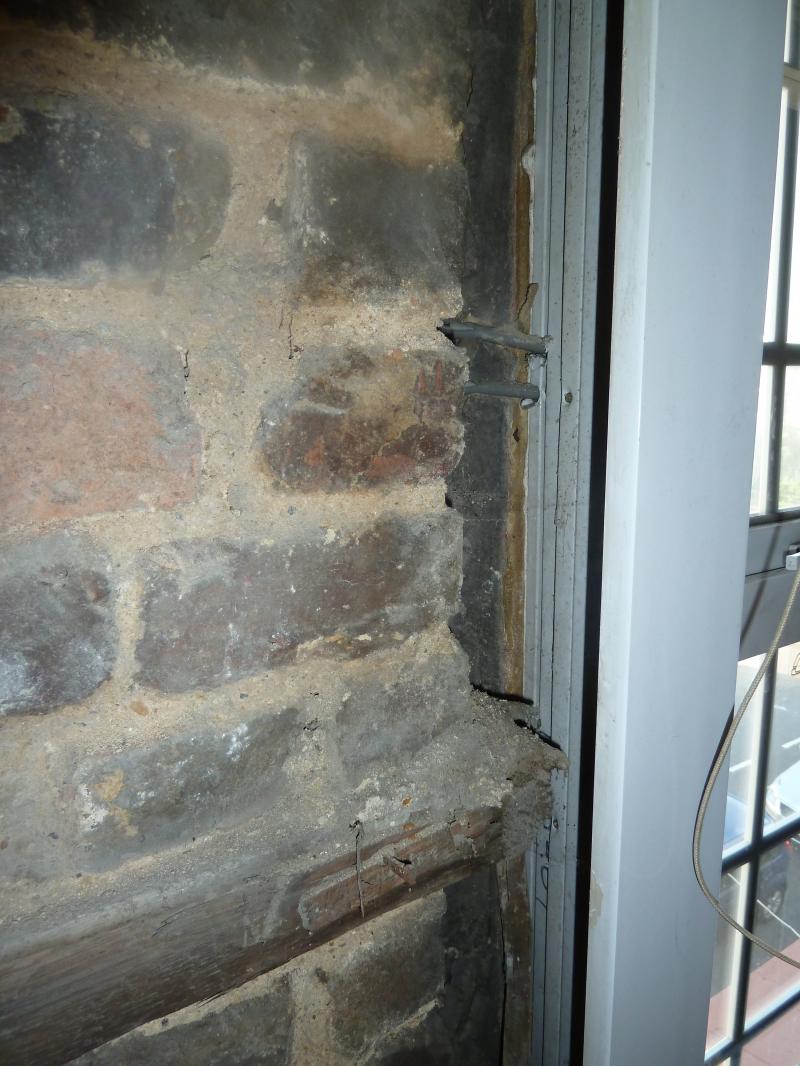

Yes. The surveyor also recommended that the current windows should be replaced with box windows. There is currently a void between the uPVC windows and the wall. An example is given in the photo below. The new windows would fill in these voids and, according to the surveyor, would help shore up the wall.
