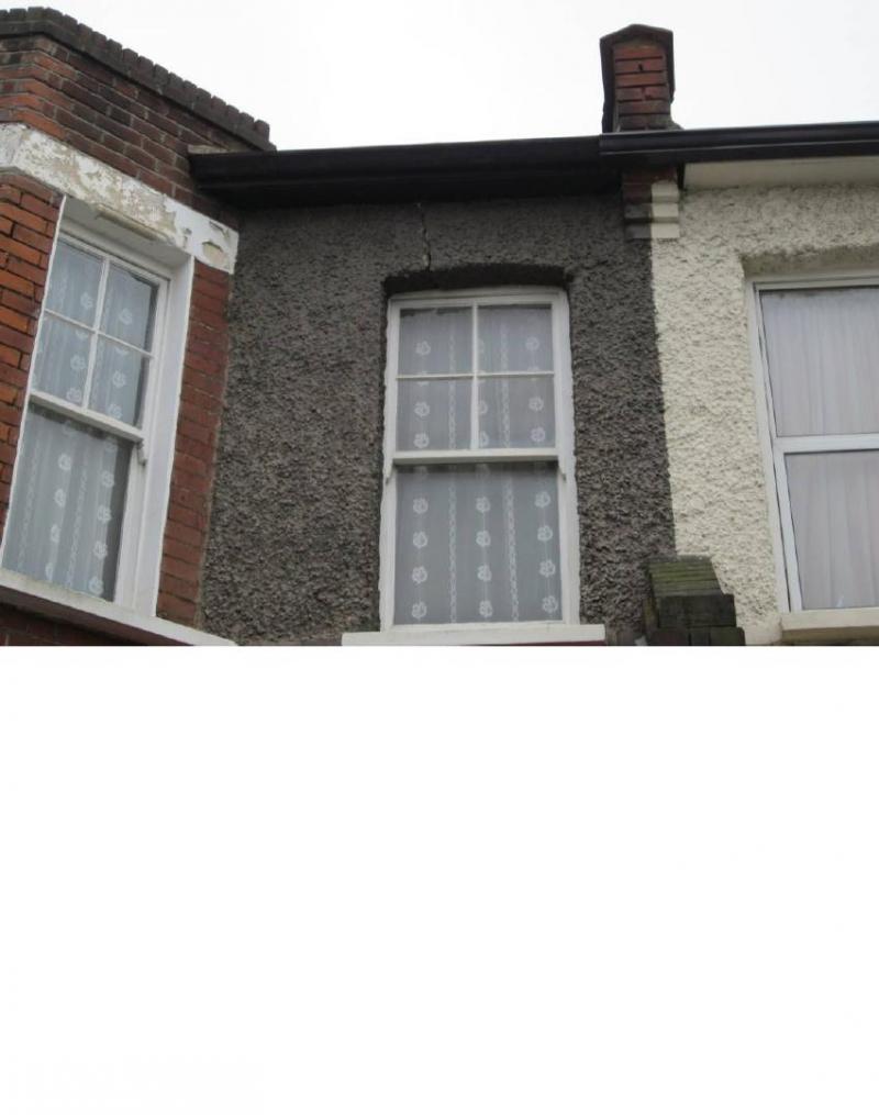

We recently bought a house where the a general movement report was provided for the cracking visible on the house.
The surveyors comments were that whilst there was a lot of cracking, he did not find evidence to suggest foundation movement or subsidence has occured in the past or is continuing.
He did recomment the cracks are strengthened by building in steel tie bars across the crack and reset the brickwork. I've seen the youtube helifix videos so this seems fairly straightforward.

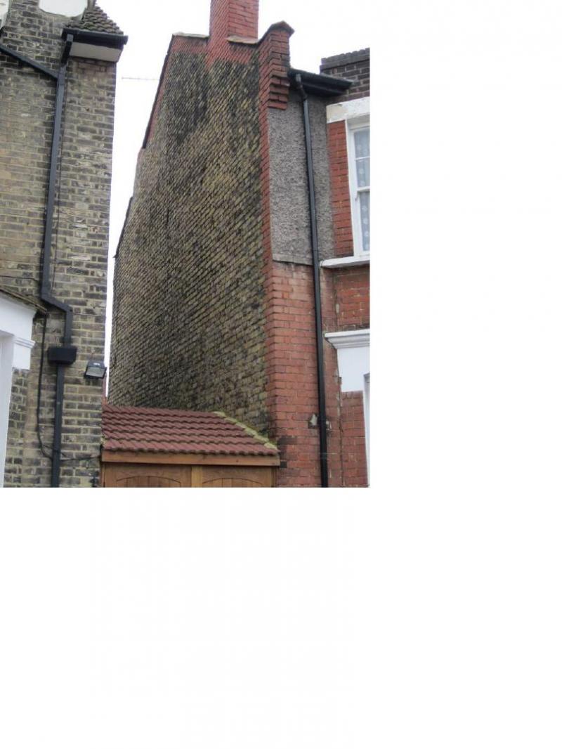

He also recommended some tying of the wall on the rear flank wall to the internal first floor using a system of bow ties. (Dont know what this involves)
So my question is, is this something that your average builder can do? (some builders have suggested using wire mesh and wall straps?)
Or do you engage a proper structural repair firm?
Do you need to inform building control? We are also plannign to extend into the rear and side, and do a loft conversion at the same time.
Any help and guidance would be much appreciated!!
(sorry cant seem to get rid of the white bits on the pictures below so looks a bit messy)

'He also recommended some tying of the wall on the rear flank wall to the internal first floor using a system of bow ties. (Dont know what this involves) '
http://www.helifix.co.uk/products/remedial_products/bt.aspx
The bow tie method of restraining a wall involves drilling holes through the wall and screwing steel rods to the floor structure. The holes drilled are then grouted up with epoxy resin to hold the wall and floor together thus restraining the wall from horizontal movement. A better explanation can be found at the web adress above.

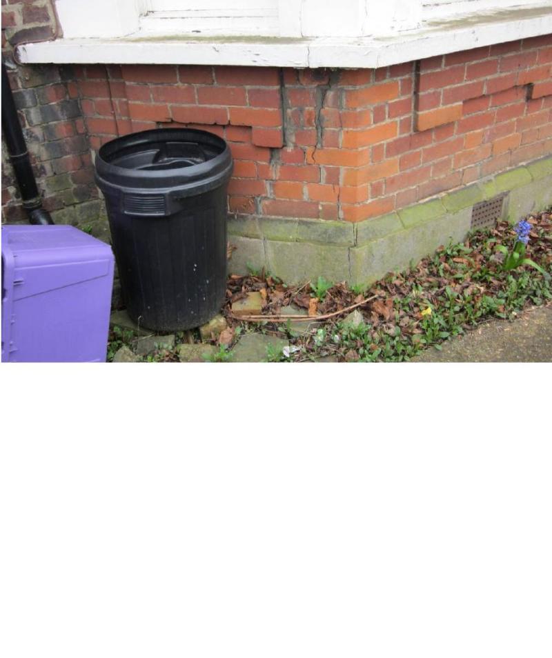

Not wanting to be the bearer of bad news but looking at the photograph of the front bay, i'm not certain that just stitching the cracks to the bay would be an adequate solution as, if movement is ongoing, the bay will more than likely crack elsewhere. You really need to ascertain whether or not movement is ongoing to determine whether the foundations require strengthening.

The crack must have been caused by something, and foundation movement is one possibility - in fact the most likely for the bay. And there must be some evidence as whether the cracking is old, recent or getting worse
So it is wrong to propose a solution (steel ties and rebuilding) without first diagnosing the cause and dealing with that. A sort of "PS - get the drains checked" is not really appropriate - the drains should be checked first
If there is a drain problem, causing the ground to soften and the foundation move, then once the drain is repaired it may well swell and so close the cracks back up. So that would be the time to do any repairs, not before

1. test pits are small holes dug to the depth of the footings, and no deeper, to enable examination of the foundation and the ground below it.
2. trees, standing or removed, are reported accountable for the majority of foundation difficulties. Drains for about 10% of, usually more serious, difficulties. I figure your main drain is running to the rear, if so, it shouldn't be a significant factor.
3. the crack in the right c/breast recess is not historic, indications are visible of past repairs, and the crack carries on to presumably the return wall.
4.Imagine the front elevation without the bay and it is ,in effect, a mass of openings with thin panels of brickwork. Perhaps the rear elev. is roughly the same -so you now have the gable wall and chimney tied in with joists and internal return wall(s). There's also the possibility of a split chimney stack.
5. However, this is mostly speculation, without more precise info. it's difficult to advise you further.
