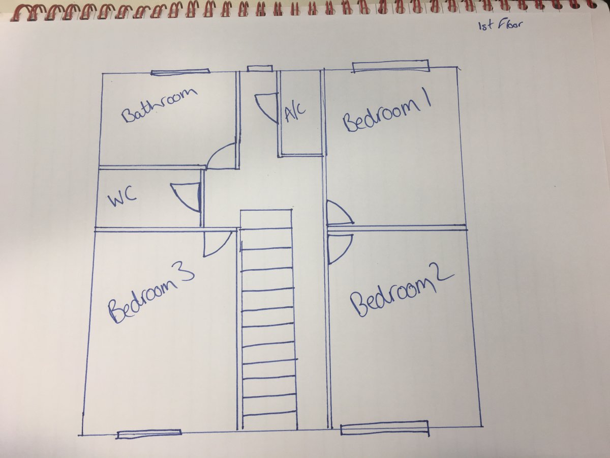

We currently have an upstairs layout as shown in the image. We are looking to knock down the wall between the WC and the bathroom to increase the size of the bathroom but wanted to check whether it was load bearing or not. All the walls in my house are masonry so it was hard to know.
The floor joists run parallel to the wall and the floorboards are perpendicular. This makes me think we are ok to take this wall down but ideally wanted some advice.
Thanks in advance.
Do the joists go from the bedroom 3 to the outside wall, and are there any roof supports from above the wall that you want to remove. Load bearing walls are normally on the ground floor, because they support the wall above it; but you can get struts going up from the WC/bathroom wall supporting the roof in some properties.
Potential to convert your property into 4 bedrooms by combining WC and bath as the 4th room and shifting bath & toilet to A/C + passage.
If your bedroom 3 & bedroom 2 face front and roof slopes towards front , it is likely that the two inner walls of bedroom 3 & 2 and the load bearing walls for your ceiling joist and possibly struts for the roof, which means you could remove the WC wall. But best to check inside your loft as others have suggested to be sure.
As Mike says - presuming the windows are at the front/back of the house then get in the loft and you'll probably find you have joists running the full width of the house from the front window of Bed 2 to the back window of Bed 1. So what you propose will make the house structurally symmetrical. The joists may not meet the standards of modern span tables though, so that's a call you'll have to make.
Get the loft and measure the joist spacing, depth, and direction, and draw another diagram.
