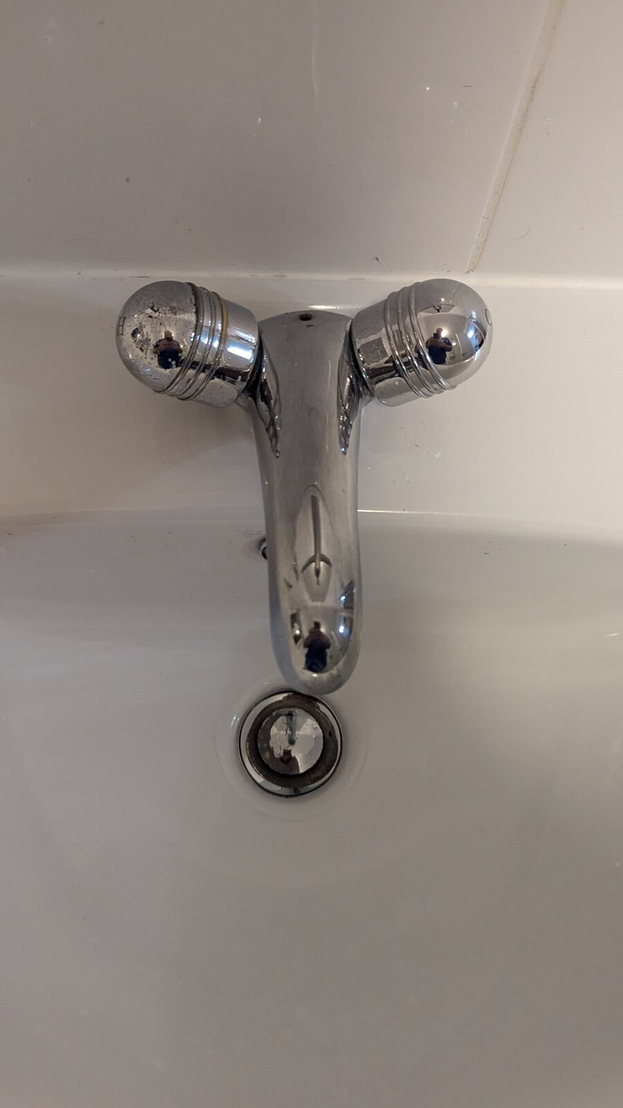

Hi, does anyone know how to get the heads off these? I think the are old ebb and flo.

Stick duck tape or masking tape to the top and pull off the small caps. Screw under.
That's what it looks like?
