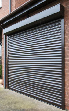

My neighbour has a new garage door - the mechanism is within the 50mm frame @ the top - are you thinking of a roller shutter one ?
Possibly......but the 300mm headroom seemed generic advice?
I was looking up electric garage doors and the roller/shutter type came up the most. Some were requiring 450mm and others 300mm. It's not imperative that we have a roller door. The sectional doors look good. But we'll have to have what fits I guess. The reasoning behind a sectional or roller door was that we wouldn't have to think about how close we park in front of the door as we are limited on parking space between the gates and the garage.

A neighbour has a roller door with the gear outside, boxed in

Not seen roller mechanisms outside. And if 300-450mm is accurate, it’ll sit above the roof line.

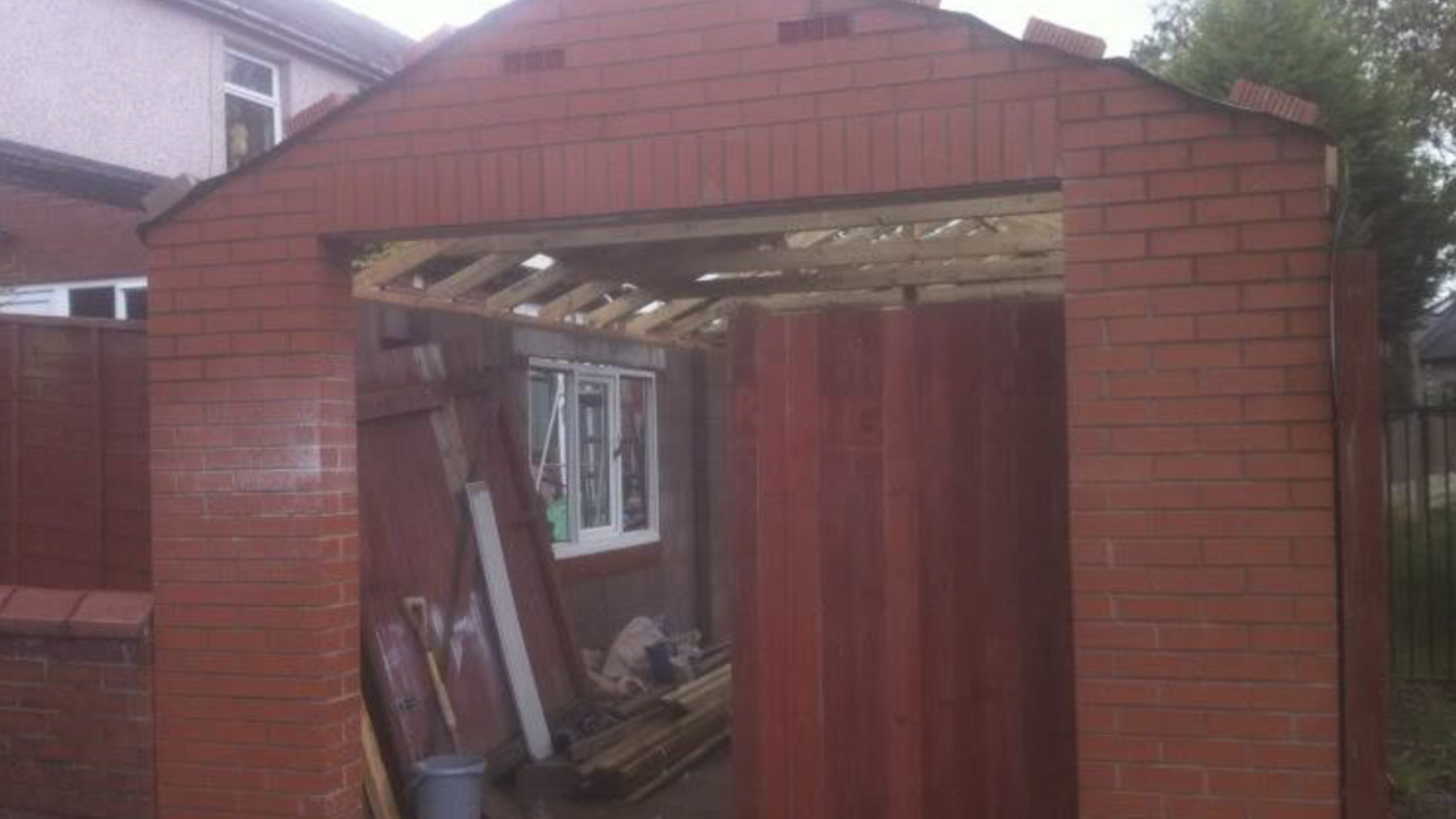

Off the net

My last garage was built like this - it was just over 4M wide and the side wall was a single brick higher than the opposite side, with 200mm joists. Incidentally, that arrangement also made it easy to convert to a pitched roof at a later date just by adding rafters.
