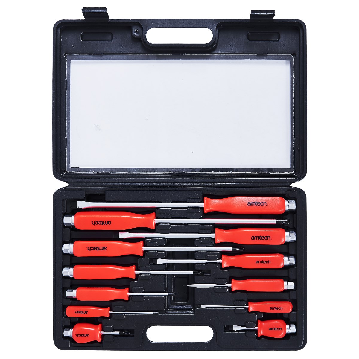

I'm wondering if as well as the whacking/torque element of an impact drill, the screwdriver bit used is important too.
I assume you are aware that there is a difference, between Phillips and Posidrive screws, drivers? The correct screwdriver, or bit, is essential to match the screw.
Bits intended for impact drivers, also tend to be tougher than normal. I have never failed to loosen tight screws, with a manual impact driver.
The set I got ages ago is a generic brand version of the below set. These are PH by eyeballing them. The driver bit that came with my Bosch drill also is PH looking at it.
The ironmongery screws I've been having problems with I am assuming are Phillips.
The screws I'm replacing them with are PZ, so I probably shouldn't be using the screwdriver set for them.
The brass colour ones are the ones I've managed to get out and replace, those are pozi, but the original mangled ones aren't?
The only way I can tell is looking for the lines though.
Wouldn't it feel obvious putting the incorrect screwdriver in as well? Like not a good fit feeling?
Not always. Both were apparently developed by the same firm in the USA and Pozi is quite similar to Phillips, until you start using power drivers when using the wrong bit can wreck the screw head.

I think the impact drivers mentioned are the type that you wack with a hammer... I bought mine from Toolstation for £7.99, but think they've gone up a bit since! Here's a similar thing from Screwfix :item 7257R
That is the very same set I bought long ago, if anything is going to work, that will. They do confuse me, which way to turn the adjuster, I always have to test it to make sure.

Given that they're sitting pretty proud of the hardware you should be able to cut a slot into them either with angle grinder, dremel of file. Then use a flat blade screw driver to get them turning. Once they've turned a few times they will be proud enough you can then take a drill and clamp the head using the chuck and whiz them out no problem. I've also seen a tip online where people place a rubber band over the rounded screw heads to help a pozi drive screw driver grip better but i've never tried it myself. Might be worth a try? Also make sure you're using the right sized pozi drive. Probably a PZ2.
normal flat bit slightly narrower banged in with a good tap diagonally across
slowest speed firmly held and unscrew
