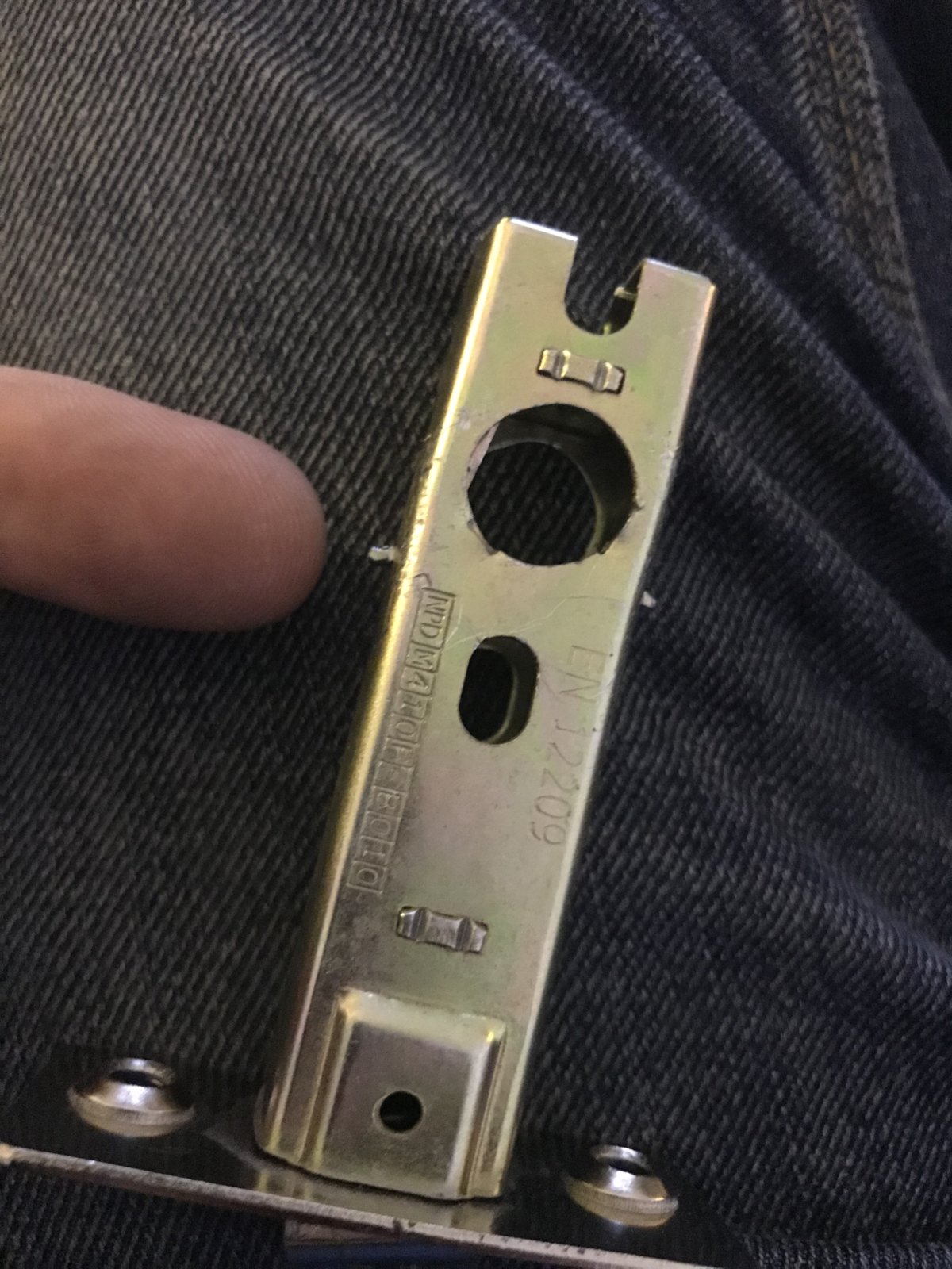

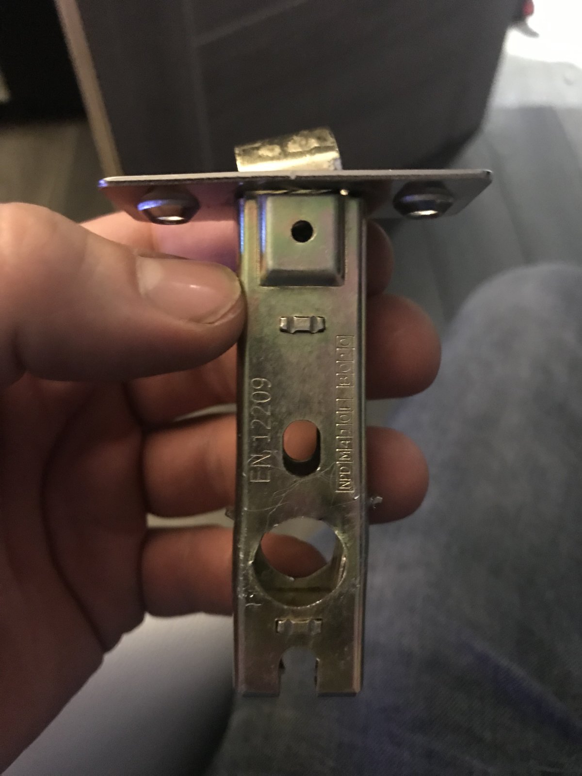

I knocked the rest of that out with a screwdriver then I think it opened when I pushed these tabs back:

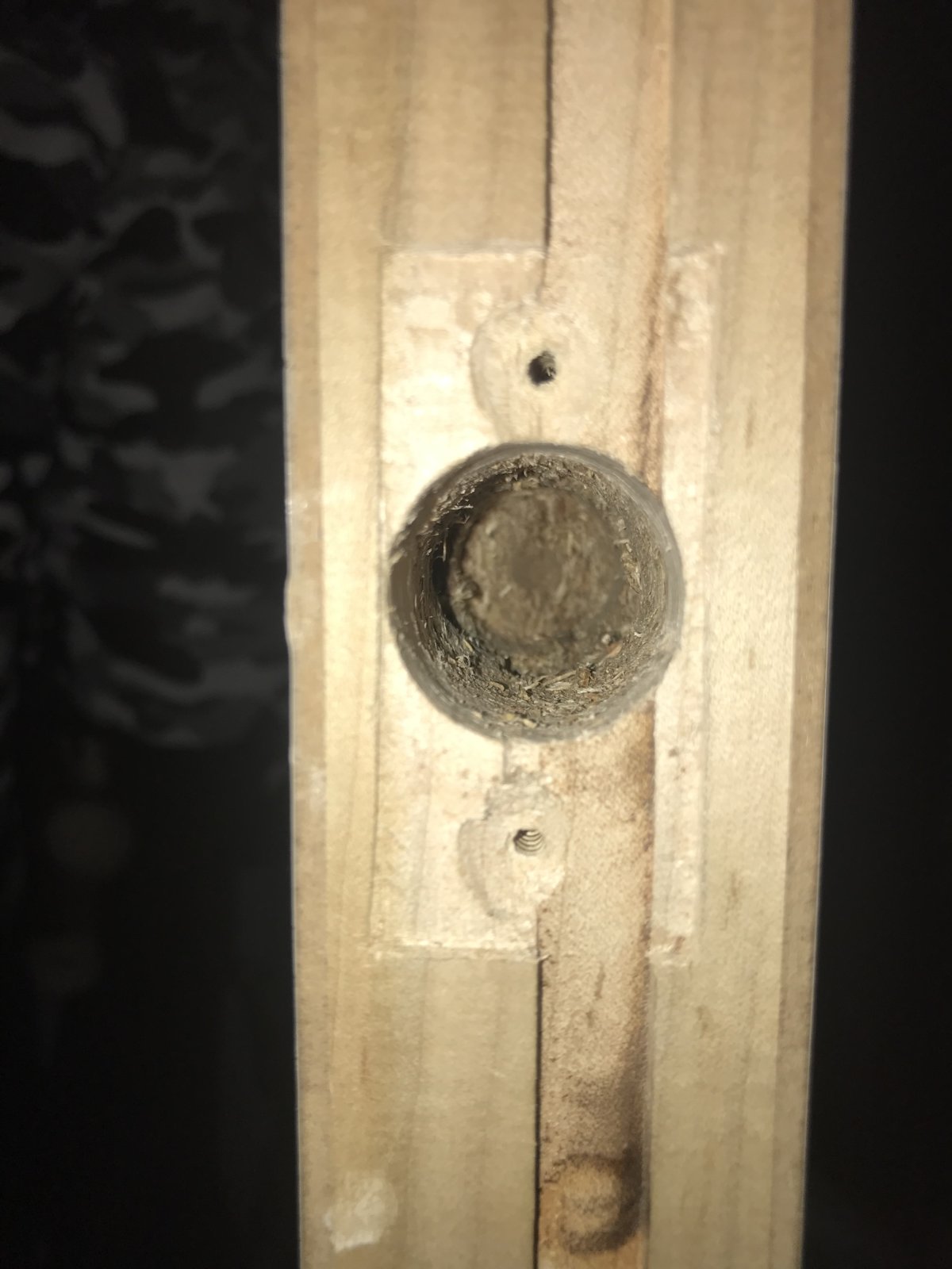

I have the same latches on all the rooms in the house so would like to know why it failed. Only thing I did different to the instructions was to use a 25mm flat bit rather than a 25.4mm but I can’t imagine that making much of a difference.
This is what it looks like now:
The hole:

If the hole is not quite large enough ( latch bonds slightly)a cheap latch will damage slightly with each use until it fails.
I’m going to square the hole top and bottom to make sure nothing touches.
