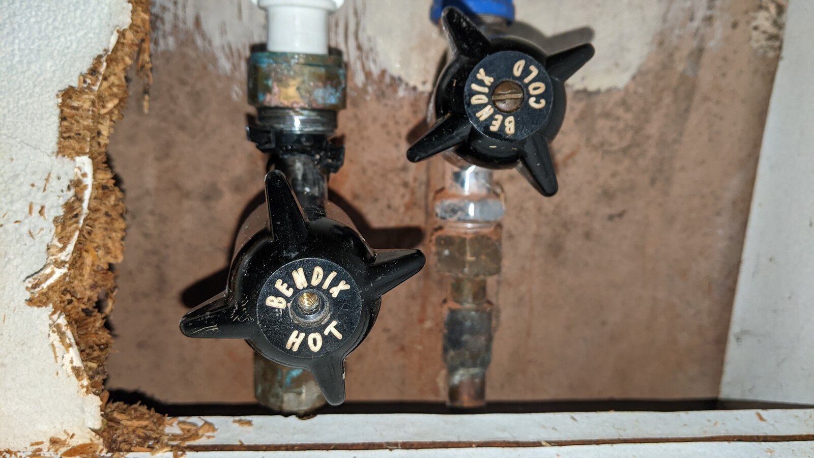

I removed the screw from the head of the tap and assumed that the plastic(?) head would just pull off. I have pulled as hard as I dare but it won't budge. Is there something that I am missing?
A piece of timber/wood, to act as a lever, between the pipe/tap base, and the arms of the head of the tap should shift it.
terryplumb, the tap is leaking when it is opened. So, I was wanting to replace the rubber o-ring that is around the spindle.
Anyway, thanks chaps. I just needed to know that I wasn't trying to remove something with force that is incapable of being removed.
Undoing the screw should allow the head to be pulled off so it's just stuck on and will need a bit of effort, just support the tap/pipe when you do it to avoid bursting anything.
