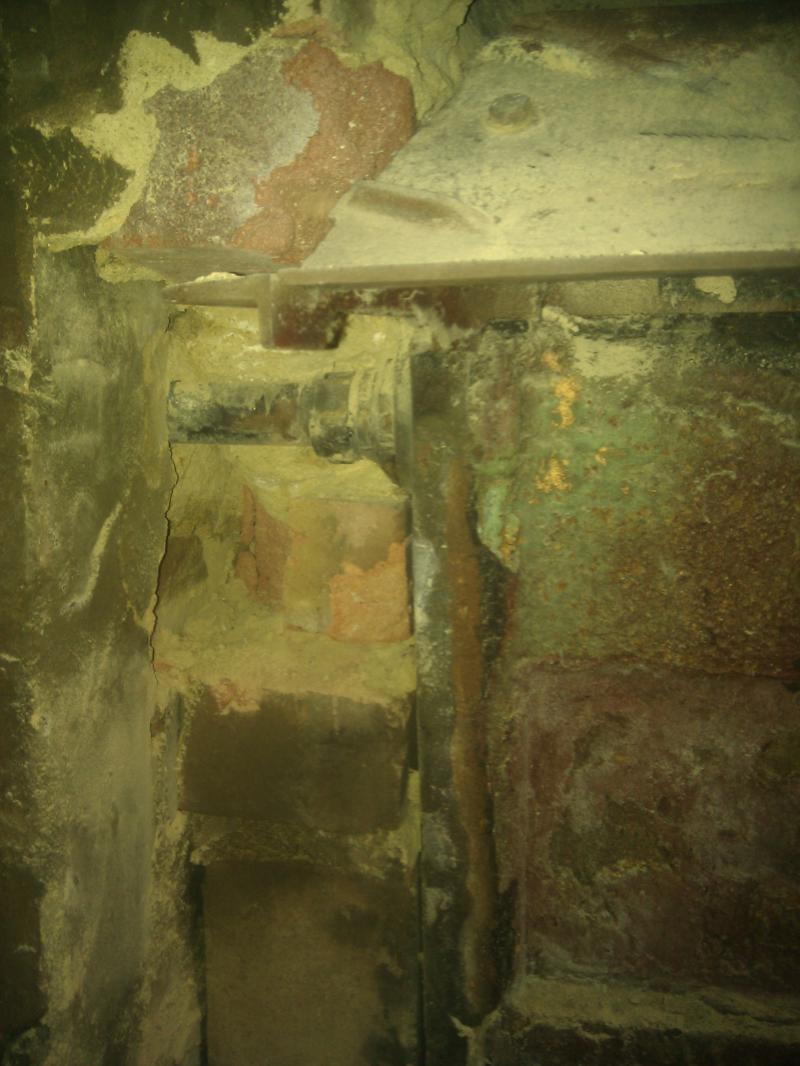

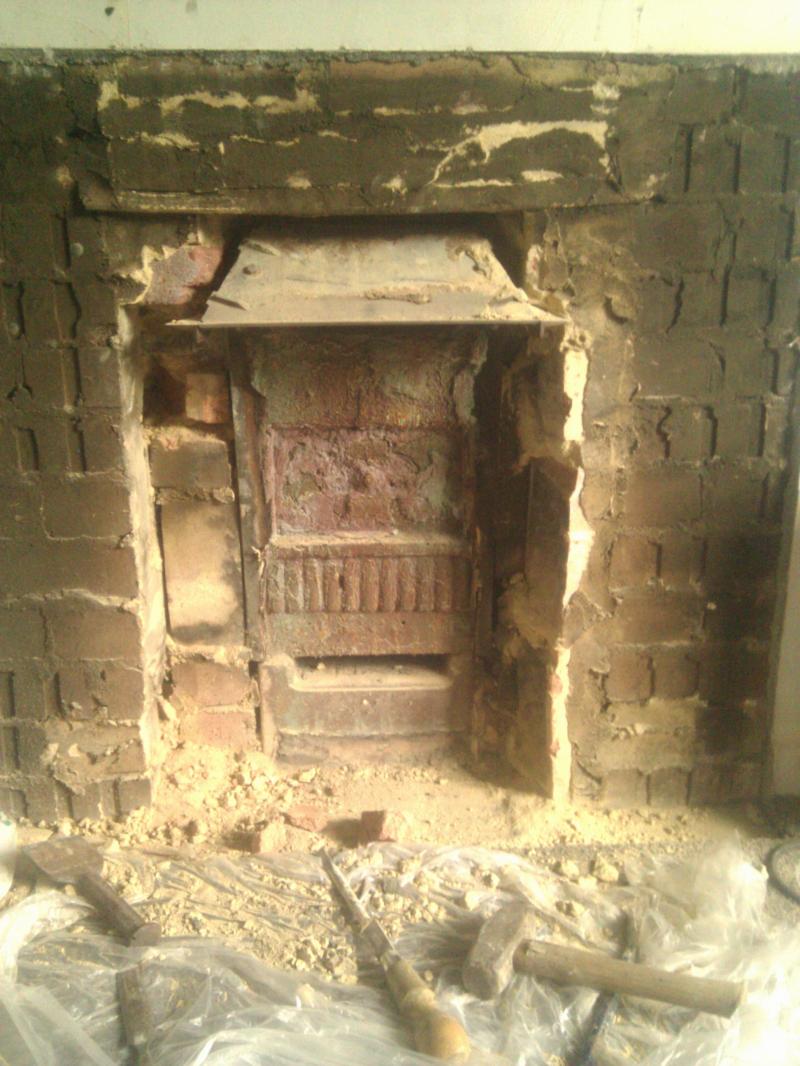

Hi. Im in the middle of helping a friend take out her old fireplace. All was going well untill I saw a pipe coming from what appears to be a metal backing to this fireplace. I have managed to drill and smash the sides out but this back bit wont shift. Im a bit worried as it only has a small lintel across. Is this a back boiler and if so is it safe to take out. Iv put some pics up. Ithink I can take more bricks out and maybe try and pull it out???.
As you can tell I really dont know what im doing. Any advise please. Damsel in distress. :rolleyes:

No I checked that today and it stays cold. I think that means it must be disconnected. It also has a small hole in the base I think someone may have drilled it to let water out. If this is the case that it is no longer live do you think from the photos that it is structurally ok to remove. I'm thinking there must be a larger lintel higher up as someone has done a bad cement job eg its not very smooth just above the small lintel.
In your photos is that a hole that's been drilled in front bottom of the boiler?
Edit. Just seen your post
at the bottom of the metal section slightly to the right is a small drill hole yes
It may seem a daft comment but why remove the fire place, just cover it over and re plaster leaving a vent. If it has to come out then just remove it, neighbours must have done something similar and had no problems. The last one I saw being removed had nothing special done before it was removed. Good luck.
