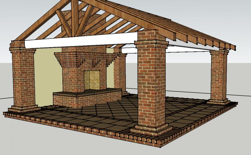

I'm planning an outdoor gazebo with concrete filled brick pillars (450 x 450) and a clay tiled roof and I'm struggling to work out what beam size I need for the spans between the pillars.
The span between the pillars are 4400 so allowing a 150 bearing (on 3 engineering bricks) the steel size would be 4700 - around the opening of a double garage really.
So far, I've worked out that the roof weight is 3100kg, so there would be a UDL of 1550kg along one steel and then a point load of 775kg (each roof gable ends supporting the ridge beam).
I have formulas from Chudleys but I'm running round in circles pumping out figures that have no meaning.
I'd read from a BC guide (san't get my hands on it now) that a 5m span 178x102x19 UB can take the weight of a 2.4m block wall - so even with a 14kg block that's a UDL of nearly 1700kg.
Would this beam be OK?

This sketchup drawing gives you a rough idea of what I'm planning.

Reading back my notes, which look foreign to me even though I did them, I'd calculated the roof area to be either 38.8m2 or 32m2. The reason being was that I read that you only take the direct vertical load rather than the actual area of the roof which includes the pitch. With this in mind I'd come to he conclusion that 32m2 equated to 0.9375kN/m2 and with a 1.5kN/m2 snow load would mean that I would have 2.4kN/m2 loading. Each pillar would then (rounded up) have a load of 20kN which would also be the point load for the beam.
Does this sound right or am I a million miles away?

There are a couple of engineering types on here who do this thing for a living so they may be able to check your calcs, so I would not really want to get involved in doing that.
But in general it seem like you have thought about everything, and its probably just the size of those beams and whether to use steel or timber.
If you are designing to BS5950, or Eurocode 3, then there are different factors to use depending on the use of the beam - restraint and deflection come to mind. So if you are doing this properly, then using the correct factors would help.
The only other thing that you might need to look at, is the racking (twisting) resistance of the roof. What will stop the rafters or the whole roof from moving sideways at the ridge and toppling over? It might be OK, but it needs considering.

@ OP, just a few suggestions on your figures:
Dead load of your roof - allow about 1.0kN/sq m; live load 0.75kN/sq m(live load measured on plan, dead load measured up slope).
If designing in steel using BS 5950, you need to 'factor-up' the loads (x by 1.4 for dead loads and 1.6 for live loads.
Max bending moment is WL/4 for the point load (on the gable ends) and WL/8 for the uniform load on the side beams.
For the rest, you really need the tables to check maximum permissible stress, and from that, you check the maximum buckling-resistance moment of your chosen beam for your span. Admittedly not easy if you don't know where to look; there is also deflection to consider.
But aside from all this figures-nonsense, why not do it the old way in timber, as ^W^ suggests? Two (or possibly 3) 2x9s should do it, and easier to fix your rafters as well.
I think you might be right, three 2x9s bolted together. I'm waiting for a price for a single 150x225 beam but I think it might be silly. Other than that I might go for the 178x102 UB.
