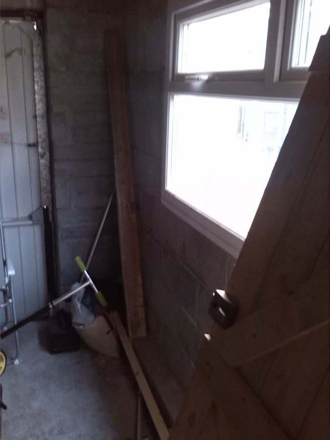

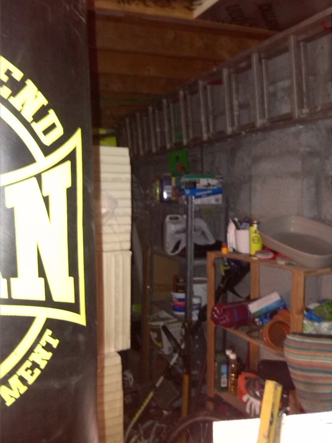

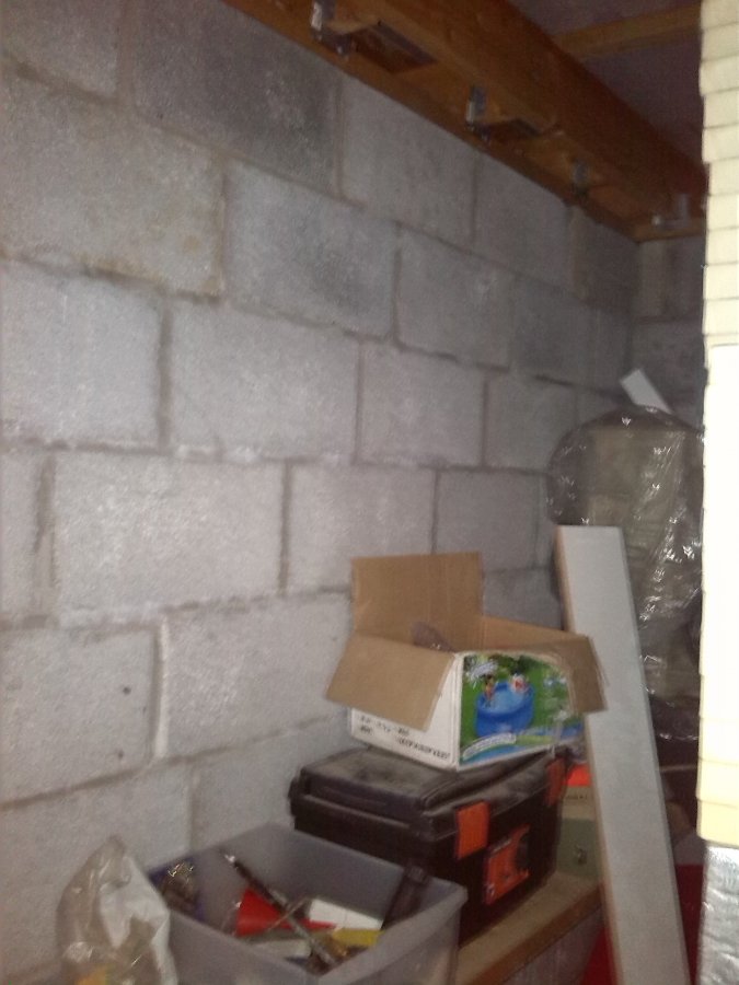

Wonder if I could ask a couple of questions on my insulating garage project:
It's a detached garage.
I bought a load of 50mm Celotex insulation and have enough to put either 100mm in ceiling and 50mm in-between stud walls (3"x2") or vice versa. Bit of a mess in there at mo so excuse the pics.
1. Which is the best place to put the 100mm (ceiling or walls?)
2. What centers should I use between studs? (450mm to be able to wedge batts in-between?)
3. I guess I don't need a vapour barrier as the batts are foil faced?
Hope someone can answer there for me, much appreciated as always.
