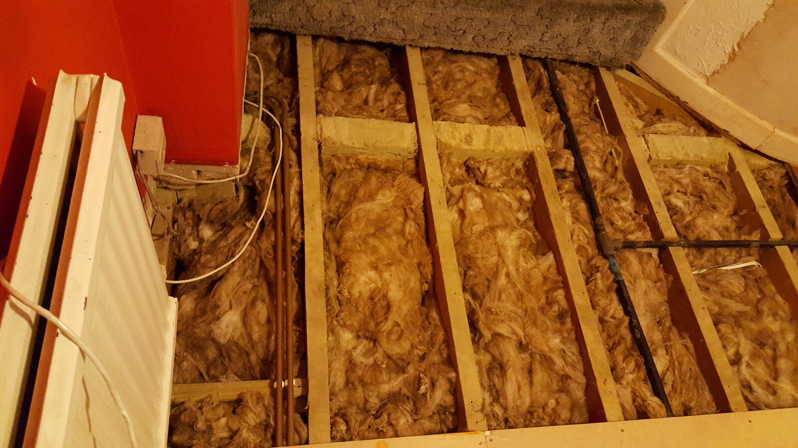

One other bonus with the softer insulation is it is much easier to get a full fill & avoid draughts. Have fun
jam loft insulation into the gap.
Mineral wool loft insulation is made almost entirely of air. Get hold of a piece and see how much effort it takes to press it from 100mm to 50mm. It easily squashes into corners and irregular shapes to block draughts. You can fluff it up again with a fork. I recommend the brown stuff treated with Ecose to prevent it shedding loose fibres and irritant dust. I would never use the yellow glassfibre again.

That works for me! Thank you for the input. Not ordered yet so will go for loft insulation option. Cheers!!!
