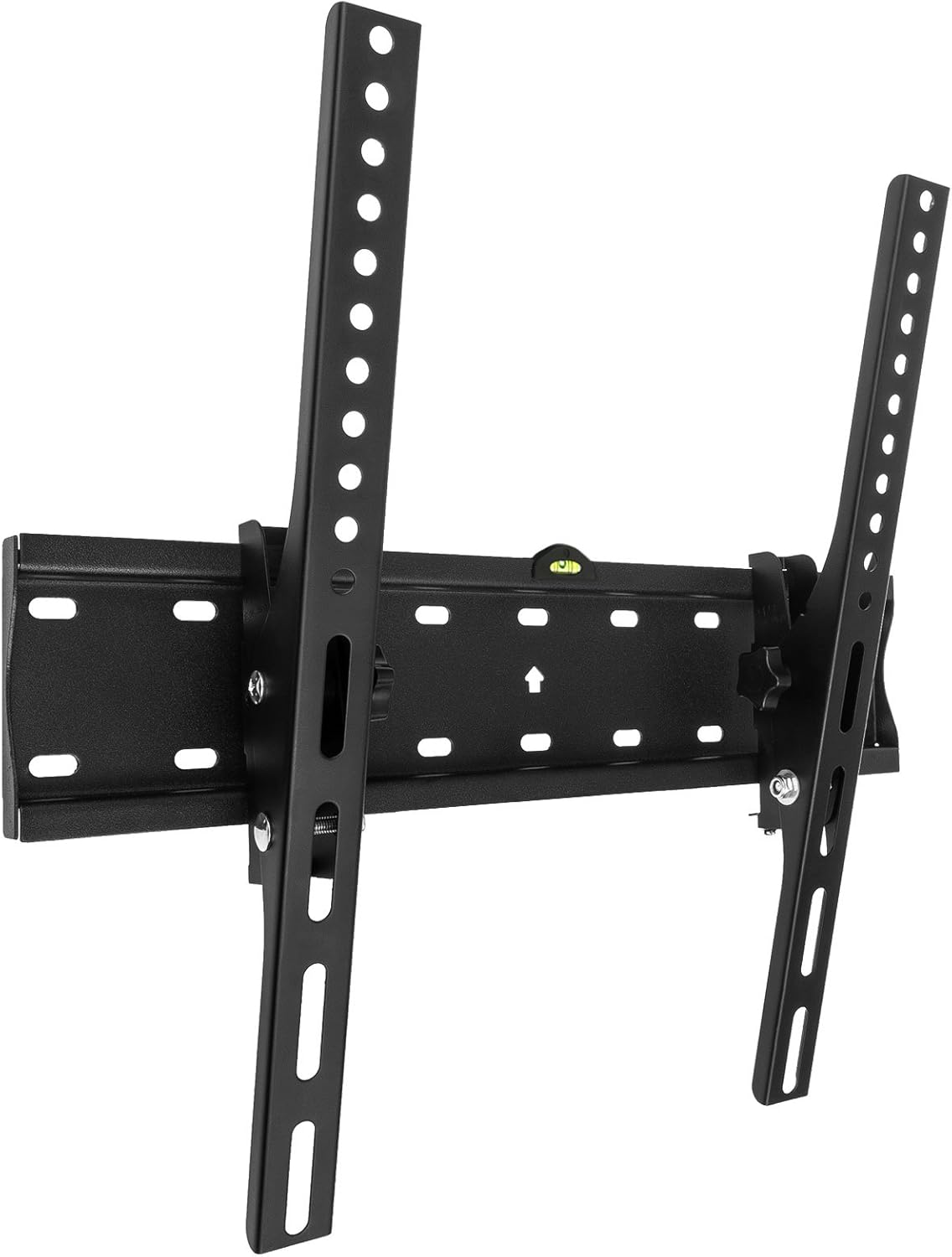

I am looking to mount a 32 inch tv to a stud wall, I’m looking for suggestions on how best to go about this, and any specific screws etc that need to be used?
many thanks in advance, Paul
What type of bracket? A nice and simple to mount flat type...
...or a pull out, cantilever, asking for trouble on a stud wall, type...
Ideally one which is most ideal for a stud wall, so I’d imagine the flat mount style?
Yes,
Do you know if there is a stud where you want the TV?
Just mark where the telly fixings need to go and install noggins at that point , then you can use any mounting you want , without worrying the TV will drop off the wall
