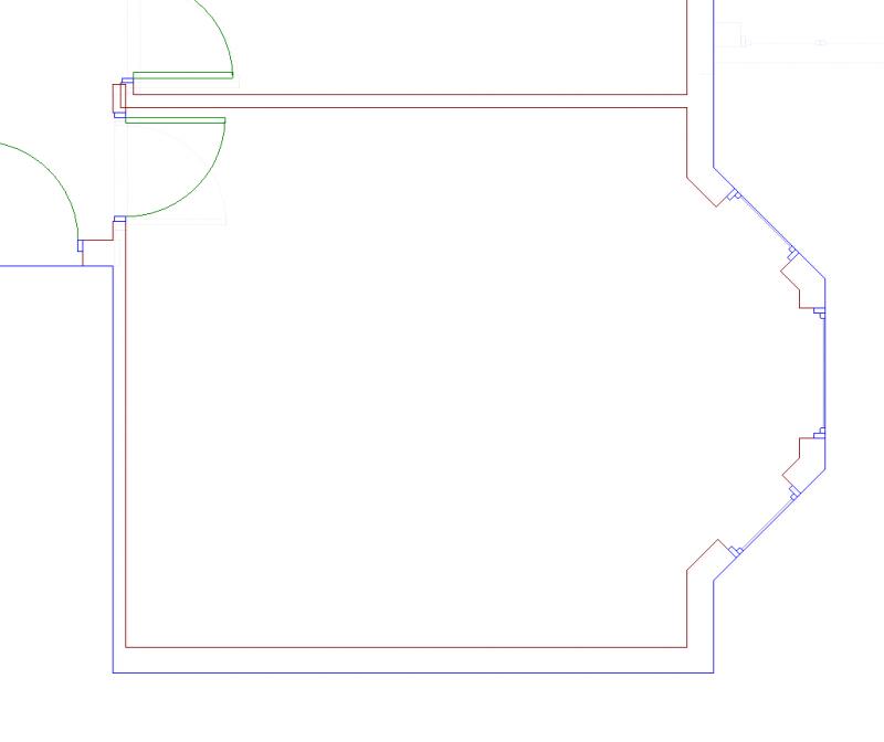

We have a first floor, 1 bed flat in Devon which had/has a large bedroom (5m x 4m appox). We decided to split it into 2 bedrooms by adding 2 stud walls see pics below.

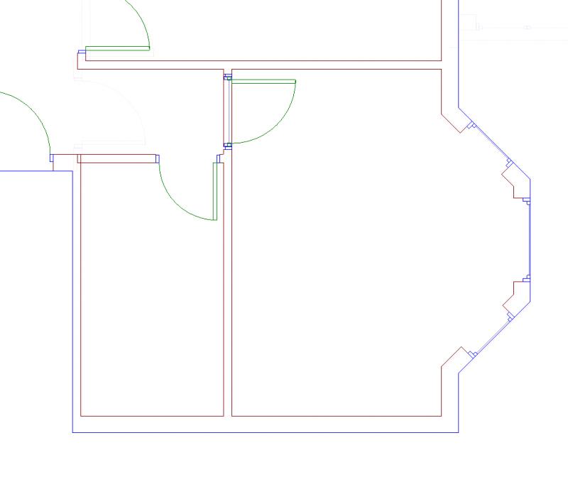

The stud walls are a timber framework, dry lined and skimmed. There are 4 glass panels in the top of the longer stud wall to let light through to the newly created bedroom.

The creating of the walls is not in itself controlled work, so the b/regs are not relevent.
The only possible b/regs issue is the bedroom without a window. A bedroom is required to have an additional means of escape to the doorway. This is normally a window, but can be anther door
However, two rooms can share a single window, so if you put a door into the new wall leading into the large bedroom, then this will comply with the b/regs (part b1).
In real terms any room can be called anything and can be slept in. However, people really need to consider what will happen if a fire starts outside a room. Having two escape routes is common sense

He is wrong with that bit; this only applies to new builds & extensions. You only need to sound insulate a stud wall between a room containing a W/C & another room & even this doesn’t apply to the wall separating an en-suite from the bedroom it serves. So it’s OK for your partner can hear your *arts but not the people in the room next door!
Sorry, forgot to add; I agree with Woody that the only problem I think you’ve got is the lack of a second escape route & lack of either natural (window) or forced ventilation in a habitable room.

You could solve all your problems by doing that but it doesn’t really make 2 useable bedrooms!
Choices for escape;
• Put another door into the new wall from the new bedroom to the large bedroom (as Woody suggested).
• Fit a new window (notifyable) in the small bedroom; which would also take care of the ventilation problem.
Choices for ventilation;
• Fit a new window (notifyable) in the small bedroom; which, with a suitable opening, would also take care of the escape problem.
• Fit a suitable extractor fan.
Personally, I would fit a new window & be done with it; more expensive & for sure but you end up with t proper job.

I would love to be able to solve the problem by fitting a window to bed 2, making it all totally "legit" but there are no external walls in that room.
It's not really possible to fit a door between the 2 bedrooms either as the bed in the main room is on that wall and there is not enough space either side for a door.
So it looks like the only option is to take the new doors off, put the original one back and have it as one bedroom with a seperate wardrobe/changing area. I'm not too unhappy with that as, at one point, I thought I was going to have to take the whole lot down.

If you omit both the new door & the wall, as far as I can see it becomes an extension of the hallway &, as such, is not a habitable room. Habitable rooms include dining rooms, lounge, kitchen, study and bedrooms, but specifically excludes WC's, bathrooms, utility rooms, landings and hallways so it all depends on what you intend to use the space for. If it’s just for the occasional sleep over, stick a sofa bed in there but if it’s going to have a proper bed & be used as a bona-fide bedroom than that’s rather stretching the point & it becomes a habitable room. But at the end of the day, whose going to know; you just won’t be able to rent it out or define it as a second bedroom when you come to sell up.
Just another thought as an alternative to the above, if I left the door to the new larger bedroom in place, and just removed the one to the small one, making it effectively part of the hallway, would that meet with the regulations or would there still be ventilation/escape issues?
Thanks again Richard. The reason that this has become an issue is that we are looking to either sell or rent it soon, so need to know what to define the extra room as on the details, without breaking any regulations. Clearly we cannot call it a bedroom due to the issues above. It seems our best bet is to take the new doors off, put the original back on and call the new small room a dressing area within the one bedroom.
