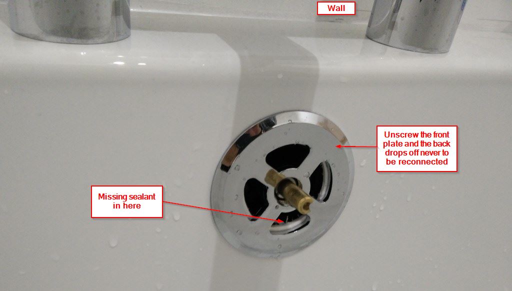

I installed a bath over Christmas and it seems I made the schoolboy error of forgetting to put sealant on the overflow where it connects to the bath. The rubber washer is pressed up against the fibreglass so it doesn't stand a chance of making a proper seal.
It wouldn't be so bad but I've finished installing the bath and I suspect it would be a challenge to get the bath back out (odd shaped room, built in cupboards trapping the bath, etc). Of course the bath has side mounted taps and overflow and they are against the wall so if I disconnect the overflow I would seriously struggle to get it back in.
I'm really hoping someone has a quick and easy solution for me as I'm not looking forward to tearing everything out again. This will, however, teach me not to forget sealant.
While writing this post I've come up with one possible solution. I could cut a hole in the wall from the back and get at the overflow that way. It's probably easier to repair the wall than basically refit half the bathroom.
Any chance you can use string to hold the back part whilst you remove the front plate?
May be a dumb idea, just thinking outside the box.
1. If the brass bit has a threaded hole in the middle, get a long screw of the same thread and use that to stop the back part disappearing.
2. If the brass bit has no thread get a bit of round wood and drill a hole in it the same diameter as the brass (or slightly less), and about half the depth of the protruding brass bit. Superglue it to the brass bit and use that to stop the back bit disappearing.
3. Loosen the chrome bit and force silicone sealant between the rubber washer and the bath.
4. Tighten the chrome bit up again, but only finger tight less 1/4 turn.
5. Leave the silicone to set, try and give it a couple of days.
6. Tighten the chrome bit up completely.
7. Cut the wood off and scrape the remnants of the brass.
If you don't feel 2 is feasible, see if you can get someone to drill a bit of brass rod the diameter of your brass bit and cross drill and thread for a grub screw.
Good thinking both. I think I can probably get a piece of string around the brass bit. Can't say I'm looking forward to the job but it's got to be better that the alternatives.
Another idea - from the other room, having measured where the overflow comes - drill a hole and use a metal rod through the wall to press the overflow against the bath - 2 people needed.
If those are inexpensive Chinky taps, you may as well fit an access panel in the other room. You will need access again to replace them.
