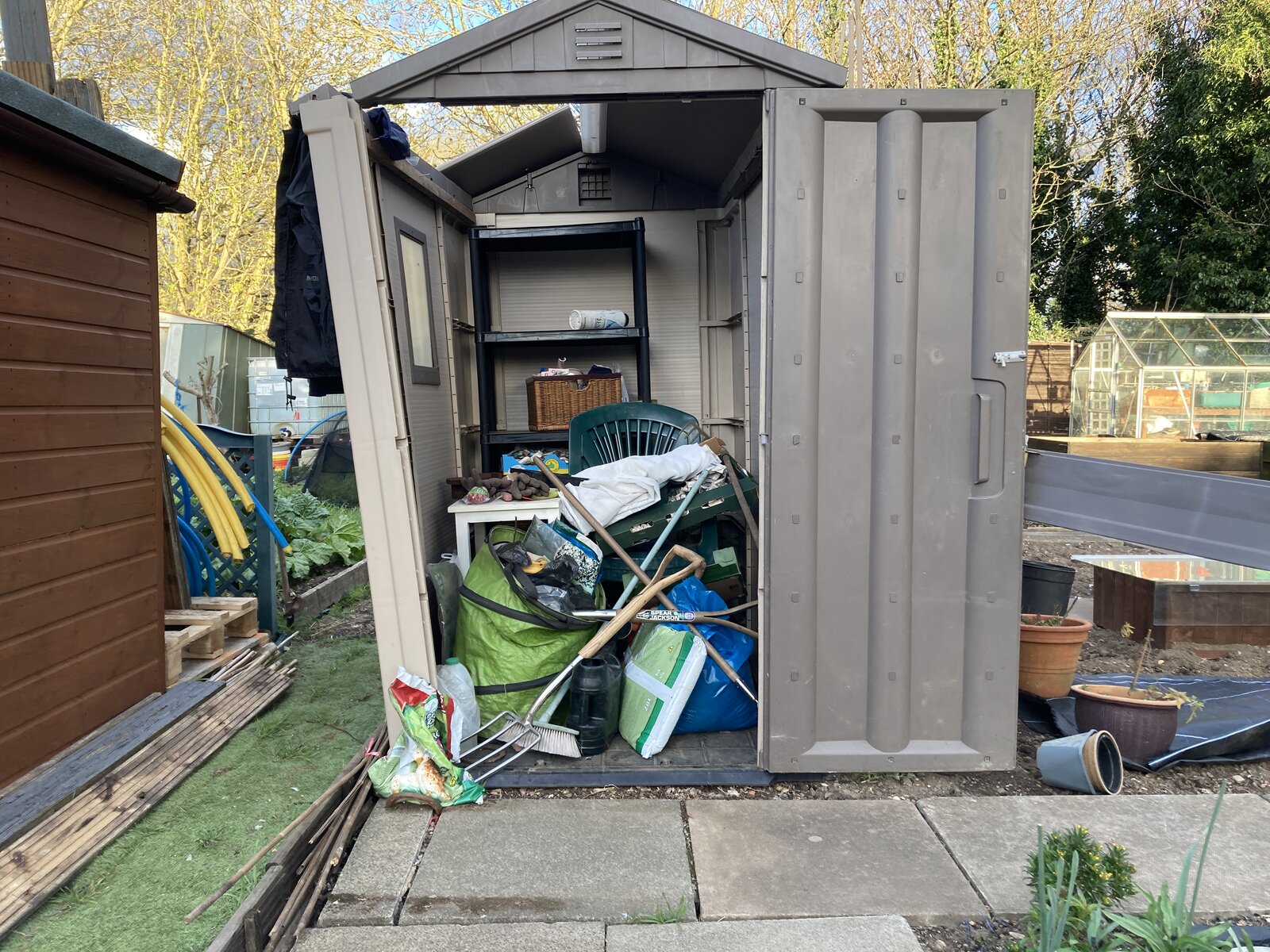

I'd secure it down and perhaps strengthen it where you can. This has how my allotment neighbours plastic shed has ended up, twice, this year in strong winds!

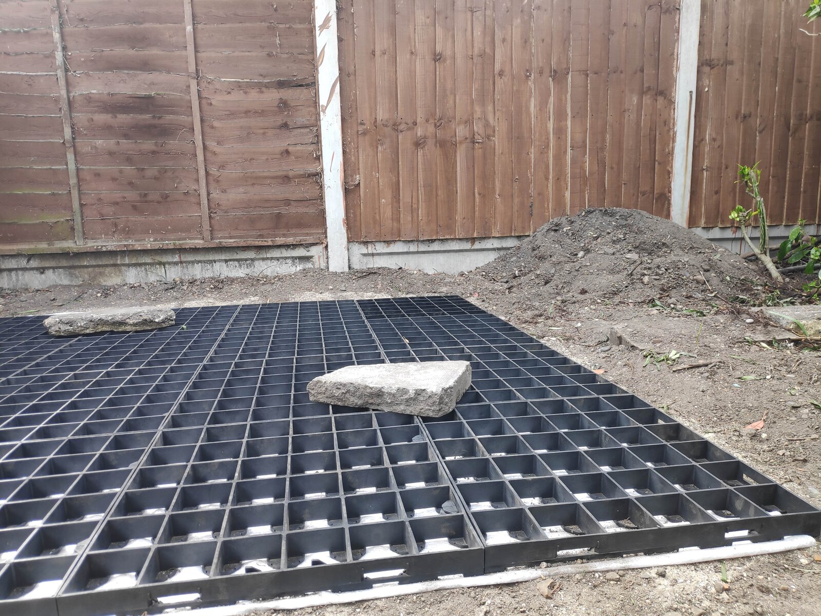

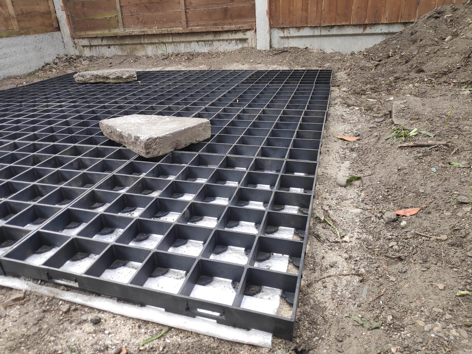

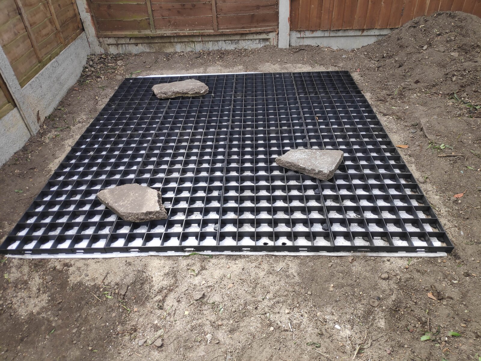

thank you for the info! I'm super grateful. I hope that I have not dug up too much tbh, the base is not sitting at the same height as the surrounding turf on all sides; this is how it looks from a few angles, again I may be worrying without reason of it getting flooded, when in fact around it is ground that would hopefully drain the water away...what are your thoughts?

Thank you for your encouragement! I was worried you'd tell me that I had it too low in with respect to the rest of the surrounding ground, and had to take it out and refill the hole! shed should arrive in the next 1-2 weeks now, so plenty of time to put the pea gravel in and see how the base behaves in the rain. fingers crossed
you have done the hard work - if it ends up flooding this winter it will be easy enough to jack it up on some blocks - no big deal.
