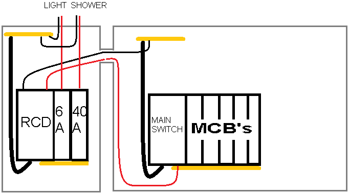

Not saying you should but you could wire the shower CU direct from the load side of the Main Switch in the main CU then you can treat each CU separately.

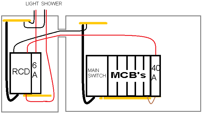

Where is the sub CU relative to the main CU.
Just confirming a 40A MCB in the main CU feeds a sub CU containing 30mA RCD & 40A MCB. What about a main switch?

Correct there is no need for it. In fact I'd go further and say it's poor practice, especially if the two CU's are not in the same place. My option would have been just a RCD in an enclosure adjacent to the main CU.
I had a situation a couple of years back where an EICR in advance of a house sale found a 4U enclusure such as
connected beside the CU with a 25mm conduit coupler and 6mm² singles (actually 7/0.044) direcly off the main switch. It contained 40A MCB for shower, 6A for bathroom light and 30mA RCD covering both. Classified as 'C1' for underrated 6mm² singles.
We added a 40A MCB to the CU and removed 40A MCB from the 4 module enclosure
