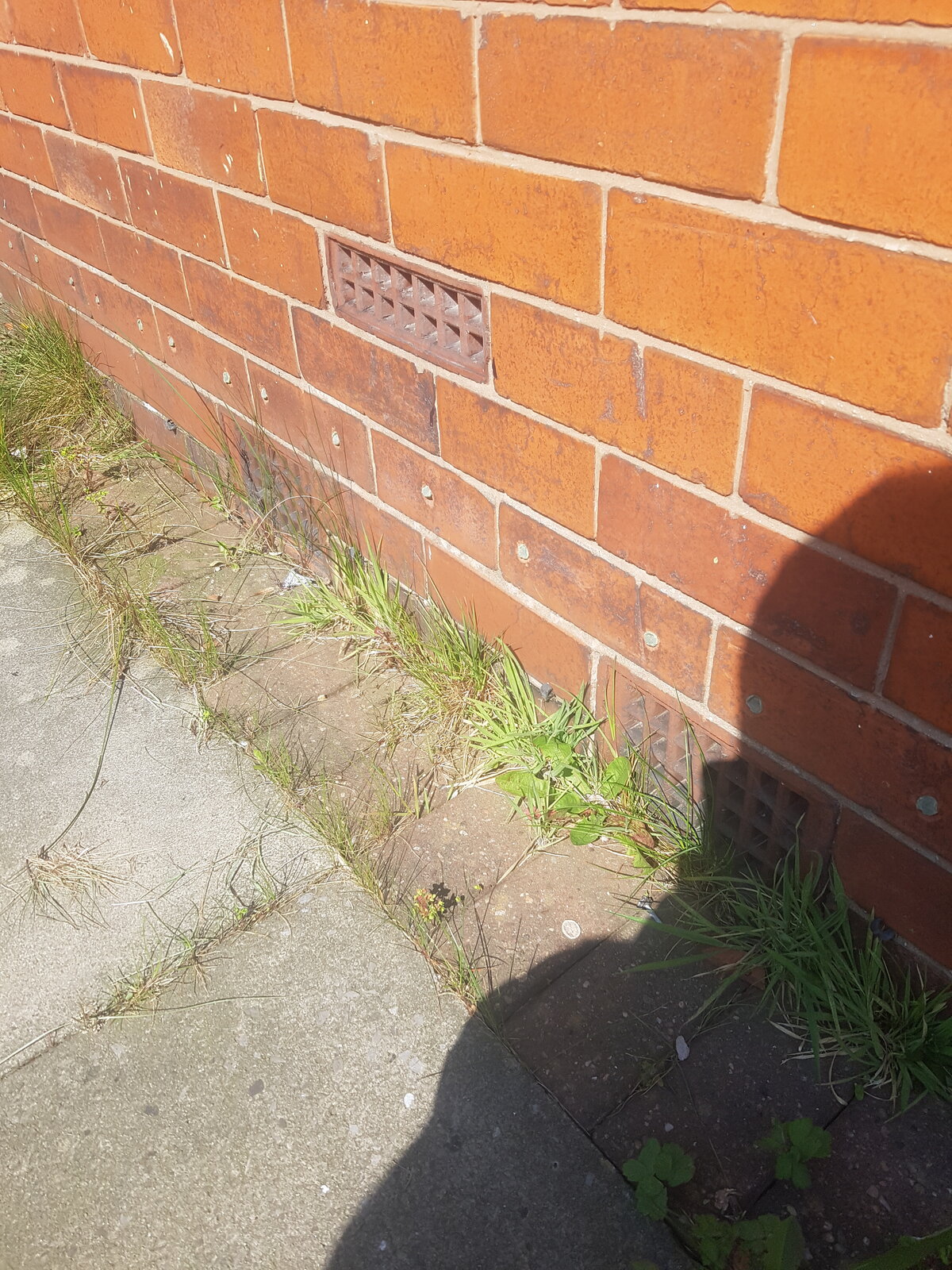

You have had an injected damp course - the series of holes drilled two courses of bricks below the vent.
Soil etc. should be kept below that row of injected bricks, both inside and outside.

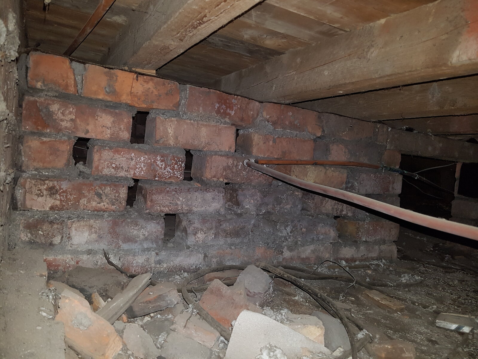

I insulated around the floor where the party wall is for soundproofing purposes. This is what it looks like down there. I'd say it was warm weather when I took these pics but no obvious signs of anything I'd say. Only problem is all the air bricks are flagged right up to. So if I put some in at the back the back garden has drainage issues so I dont want water to leak in. Its never reached the house. You know when you move in somewhere and over the years you pick up one problem after the other

I know. We have never suffered any damp problems while we lived here. I dont know about previous owners. I know sometimes surveyors can demand the damp course is done to be on the safe side
You are smelling mould spores and you do have a problem somewhere. Probably insufficient ventilation in the floor void.

You say it is a 1930's house. So I'll wager it was built with a DPC. So it should not need chemical injection. The brickwork in your pic looks very good. But at the bottom of your pic I can see an airbrick, close to the paving and obscured by weeds and shadow.
This leads me to suppose that the ground level has been raised since the house was built (this is a very common error by idiots) and may well have bridged the DPC or allowed water to splash up and through the airbricks. Such action frequently leads to damp.
The correct action would be to remove the paving and reduce the ground level next to the house.
You say there are no airbricks at the back of the house. This means there will be no airflow from front to back to ventilate away damp. Maybe the back has also had the ground level raised.
You need to expose or provide ventilation all round the house.
You are correct the patio is the exact same at the back. Its level is level with the air bricks. The dpc is above the air bricks. The chemical injection is just above the dpc. I'm guessing for now try to get air bricks in at the back and see if it helps. If not then at some point I will have to lower the flags which is a major job. At the minute at least most water will run away from the house and vents. If I lower the flags the water may pool at the house then. The weeds have been taken care of. Thats quite an old picture
Would I be better removing the small paving bricks around the vent and digging down and putting pea gravel down and having it lower than the air brick? I figure with how it is at least most of the water will drain away due to the slope and not pool at the house
