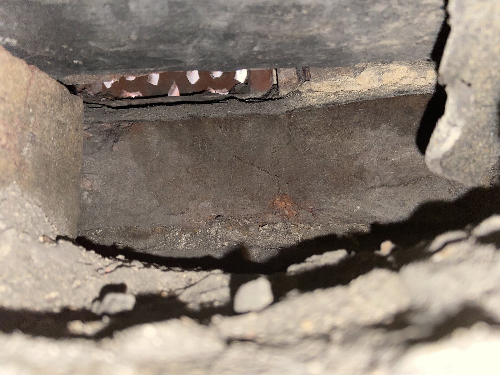

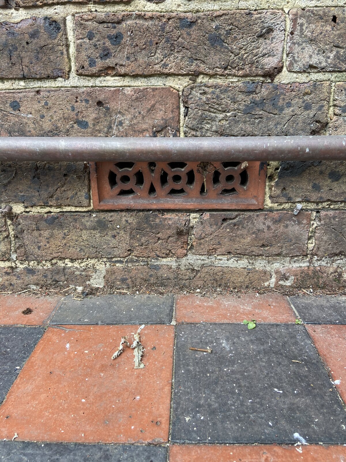

Hi John,
best photos I can get attached. You can only see the air vent from the inside by angling your phone, not by sight. This is the only one we can get a pic of, others you can feel with your fingers if you reach around some odd spaces!
yes Edwardian.

OK, the airbricks look original, and not blocked. I'm not sure I can see a cavity wall.
The one you show does not show any damp signs.
the ground level has been raised by the thickness of the modern paving
