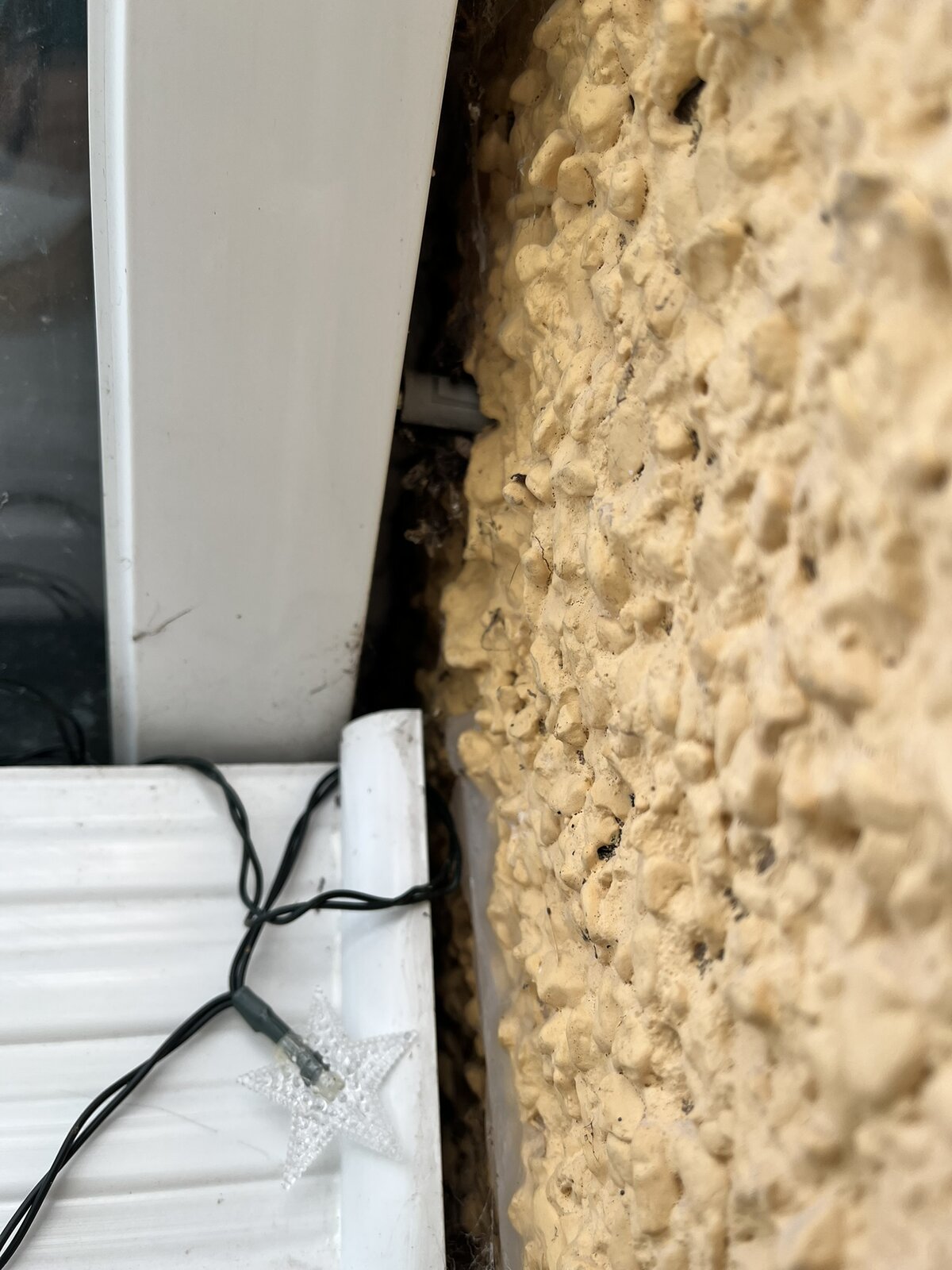

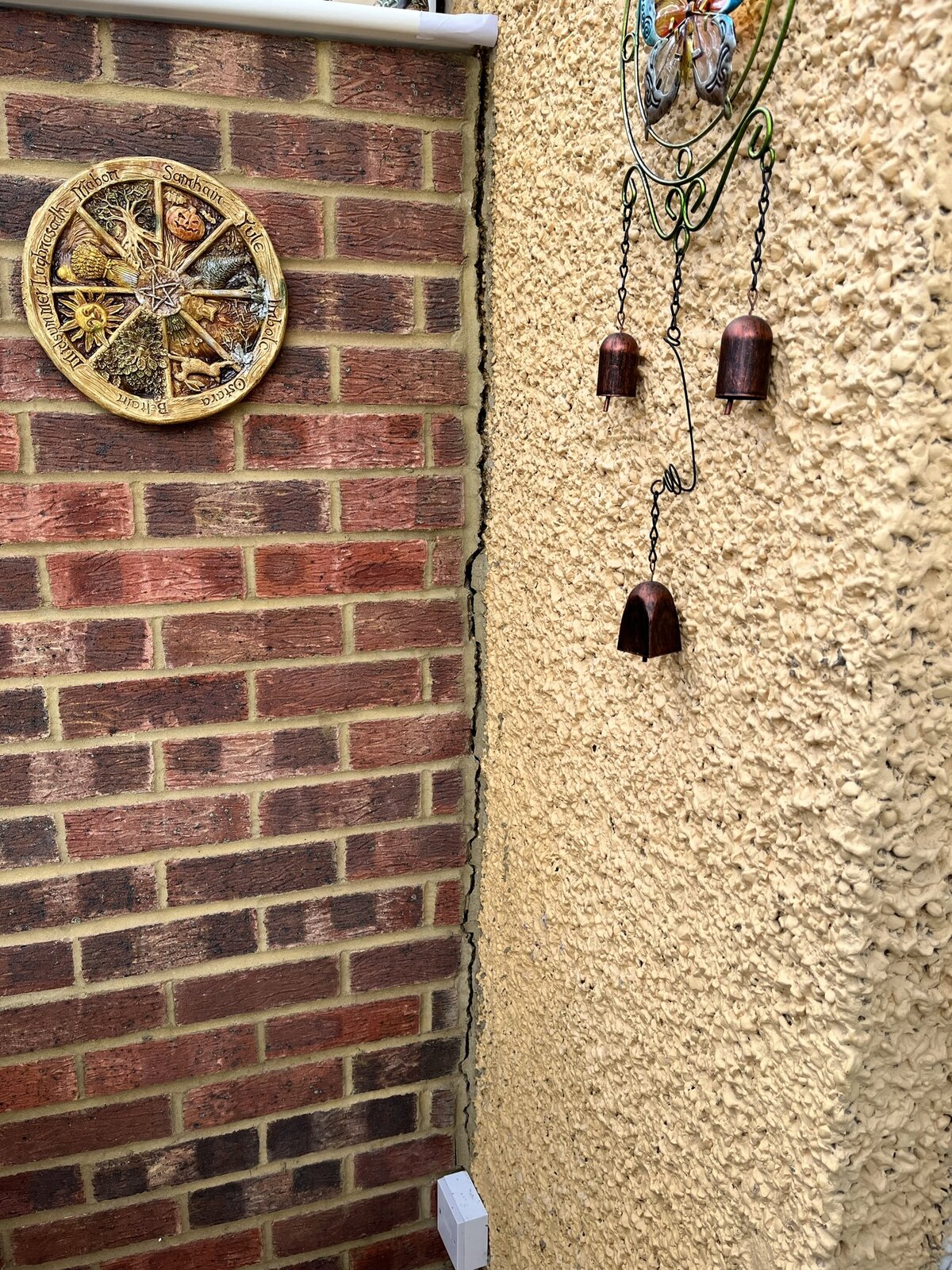

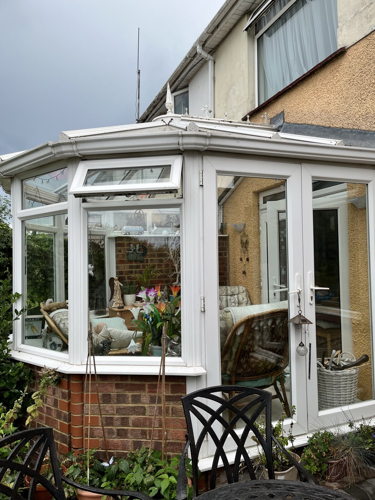

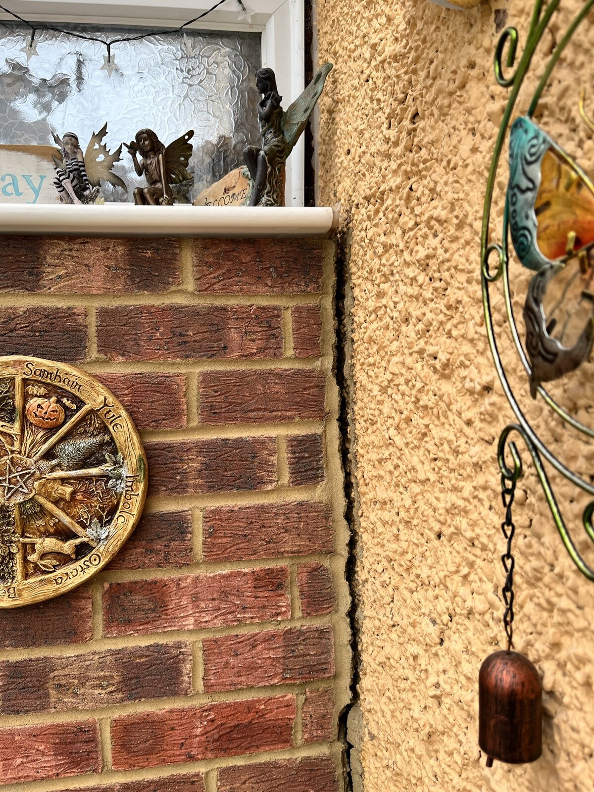

I need some advice please. I have a conservatory which is approx nineteen years old but it’s a good one put in by Zenith windows by previous occupants of my house. I’ve been here for the last thirteen years and it’s been fine.. no issues . But earlier this year a crack appeared between the brick wall and the house. The conservatory doors are misaligned too.
l‘ve had a builder round to look at it - from a reputable local company- who says the foundations need underpinning. I asked him about whether it was best to have it taken down and he said it was a good conservatory and would add value to the house if underpinned.
my concern is that if I go through building regs or insurance, my house value will go down and my insurance premiums rocket. if I don’t go through those routes and still have the underpinning done and I then sell the house I will not have a clear conscience
if I have it taken down then the costs of the removal and subsequent making good, is just over a grand cheaper than having it underpinned.
I really can’t decide which is the best route to go and hoping for some advice. money Is limited as I am now officially an OAP. I think my builder is fed up with me asking questions Please can you help me decide which way to go forward?

Thank you for your replies.. am concerned this started early last year as there was a hairline crack running up.. early this year the crack between the brick wall and house opened to about one centimetre but doing the summer the gap has become bigger.. so the hot weather has made it worse but it was there last year.. I questioned my builder if the heat had affected it but he looked round the conservatory and said he didn’t think that was the cause and said that most conservatories did not have deep enough foundations .. the gap between the wall and house has deepened to approx an inch..as previously stated the doors to the conservatory are definitely misaligned now .They shut but there is a gap at the top of one side…

An inch?! At the top of the dwarf wall?! That’s pretty significant movement!
25 feet away is close enough for trees to have a significant influence depending on the species and the volume change potential of the clay soil, especially considering the foundations are likely pretty shallow.
It’s the dry weather that causes an issue more than the heat. The trees still need to drink, and will continue to extract water from the clay, causing it to shrink.
It might close up a bit in the winter but unlikely it’ll close up an inch.

Tbh I have stopped using the doors as they are so misaligned.. the conservatory is nice but like all conservatories they get too hot in the summer and too cold in the winter.. my two cats love it but it’s totally unusable in the winter months
