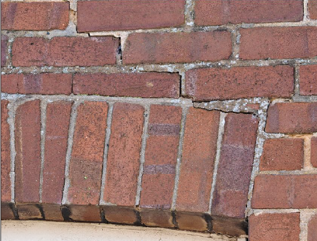

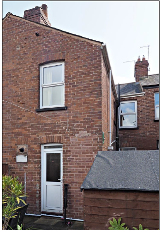

The arch has dropped. Common thing, and again I can't see how a supposedly qualified surveyor is associating that cracking with foundation movement.
Does he, in other parts of the report, even explore the many possible reasons for that type of cracking, discount the least likely and conclude by reasoned explanation the most likely cause and the reasons why? If not, he's clueless and not doing his job.
Hey Woody, he mentions the following in the report about cracking at this location. I am worried he is a bit of a cautious person by nature and in this report but as people who have never had a survey done before it has got us worrying.

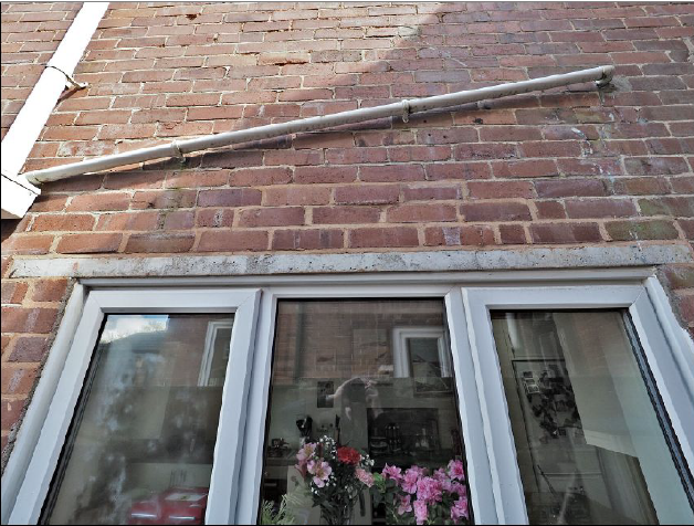

Rear Gable Elevation
The wall on the ground floor appears satisfactorily plumb overall, and sighting up to
higher level there are similarly no signs of any substantial deviations from the vertical
on the first floor. There does, however, appear to be an outwards lean at high level
up to the roof apex and we assess that the brickwork may have displaced by a
maximum of 25mm-50mm.
Within the brick coursing the trend is difficult to determine, it being suspected that
the mismatch in alignment about the rear doorway is at least partly as built. Our
impression at low level is of some sloping towards the external corner, although there
is evidence also of a slight drop towards the party wall. The fact that almost complete
repointing has been carried out in between the doorway and external corner suggests
that some historic movement or other damage may have been disguised; however
there is no apparent cracking in this area. Also, the brick arch lintel over the door
appears reasonably uniform and intact (photo 03).

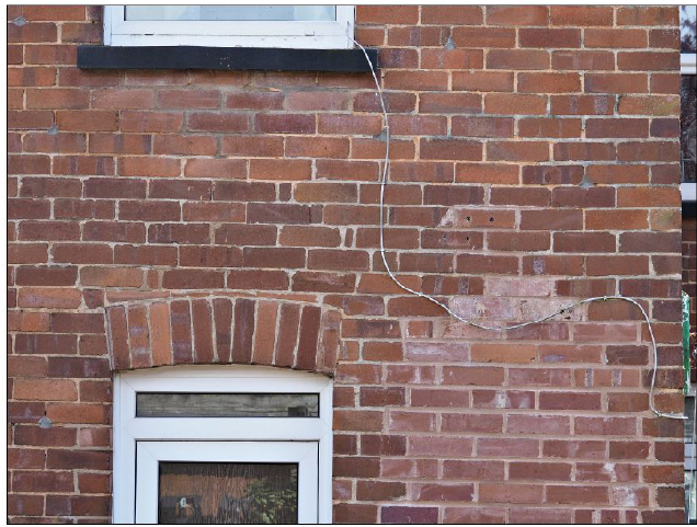

There is diagonal stepped cracking at high level, originating from the top corners of
the first floor window and converging below the roof line. The cracking appears
substantially discoloured and weathered, and we estimate a maximum width of
around 5mm. The cracking must correspond with slight dropping in the brickwork
above the window, although the arch lintel appears to remain reasonably uniform and
intact (photos 04, 05).

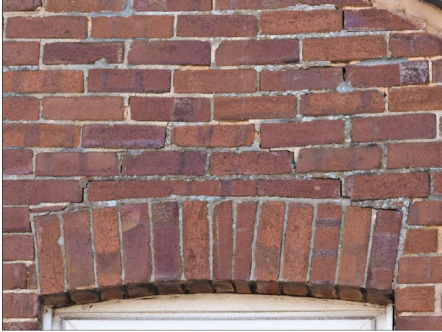

Some additional localised diagonal stepped cracking is evident in between the top of
the bedroom window and party wall, in a top left/bottom right orientation (photo 06).
It is assumed that a continuation of the cracking into the neighbouring property has
been disguised by repointing, where there is no obvious damage visible. To the rear
wall of no. 4, however, there is substantial erosion of the mortar joints and some
localised old deteriorating assumed cement based mortar patching, with mortar being
loose, displaced or missing in places. There is again evidence of retro-fitted cavity
wall insulation in the form of a number of filled drill holes.
Photo 5 below. Photo 3 & 4 above
My guess would be that a new window had been fitted, which disturbed/didn't support the arch quite so well as before.
Thanks for this, so not something too much to worry about and in needing of special attention? If we repointed it would that be enough or should we be looking to strengthen it do you think?
Me, personally, I would just repoint it as is - but woody will have a better idea.
We can get a CCTV survey of the drains done fairly easily and inexpensively but if this finds nothing then what would be the likely reason for this 'movement'? Is the drain really a likely candidate or are we now saying it is unlikely to be subsidence at all?

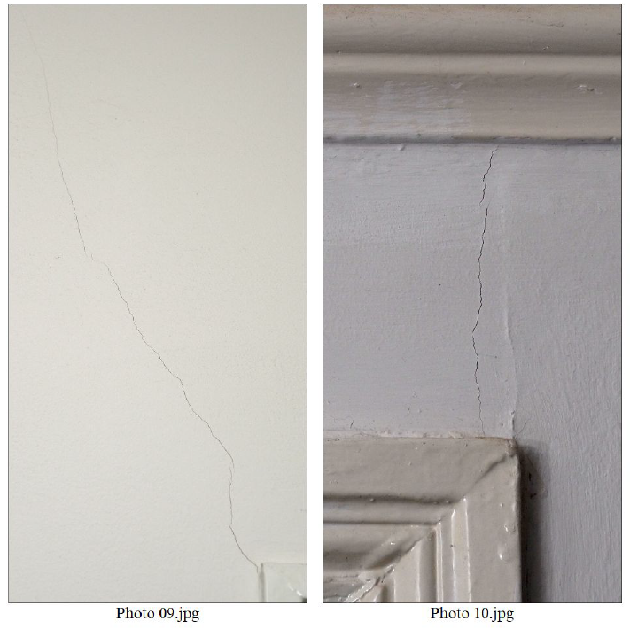

Just saw this in the report and thought it might be more important for this issue:
There is minor ceiling cracking, 0.5mm wide or less. To the walls there are no signs
of any structurally significant defects showing through the decorations. There is
minor diagonal stepped cracking emanating from the top left hand corner of the
centre bedroom doorway, less than 1mm wide and in relation to what appears to
comprise an original timber stud, lath and plaster partition, only around 105mm thick
overall (photo 09). The top of the door frame drops towards the front by around
12mm and there is a tapered gap along the top edge of the door, which is otherwise a
reasonable fit in the frame. The front bedroom door frame appears reasonably square
and there is minor localised diagonal cracking, 0.5mm wide or less emanating from
the top right hand corner (photo 10).
In the built-in cupboard, where inspection could be locally carried out at high level,
there is minor discoloured cracking along the wall and ceiling junctions and also
across the corner of the ceiling in relation to decorations of extreme age, not
appearing to much exceed around 1mm wide.

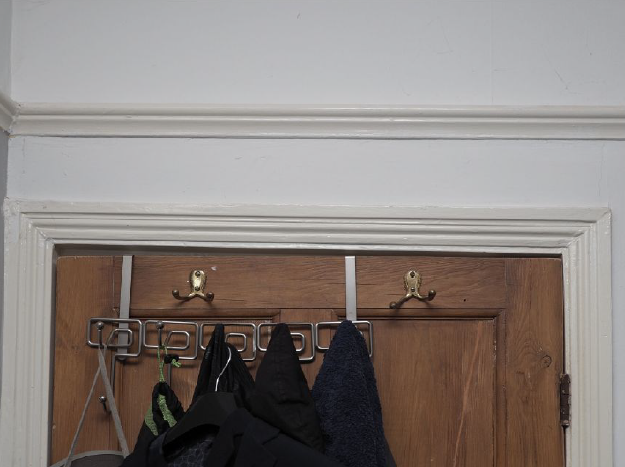

Into the zone of the rear projection there is moderate misalignment of the bathroom
and rear bedroom 3 doorways. The top of the bedroom door frame rakes down by
around 15mm away from the party wall (photo 11) and there is a similar slope down
towards the rear across the bathroom opening. In the latter instance there is also
minor diagonal cracking emanating from the top right hand corner of the frame,
discoloured and 0.5mm wide or less (photo 08). In both instances there is little if any
evidence of opening up of the timber frame/architrave joints since last redecorated.
Both doors also appear to be a reasonable fit in the frames.
