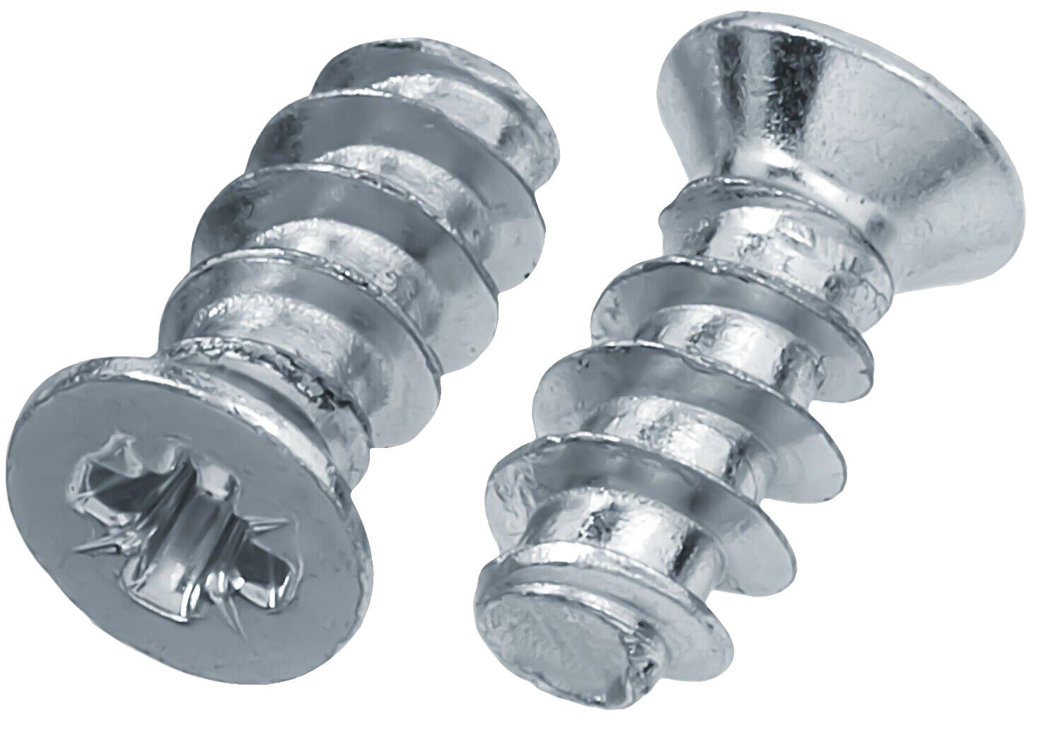

Furniture screws, eh. Thanks. That seems to be it
(Though the one illustrated in the instructions is a Euroscrew)
Might also be called Confirmat screws.
For the benefit of non-Europeans, the Euroscrew for kitchen cabinets has a thick, unpointed shaft, with a coarse, biting, untapered thread, I suppose to take a lot of weight in quite a shallow hole, in weak material, and a relatively small countersunk head. They are usually much shorter.

Confirmat screws is what i know them as.
