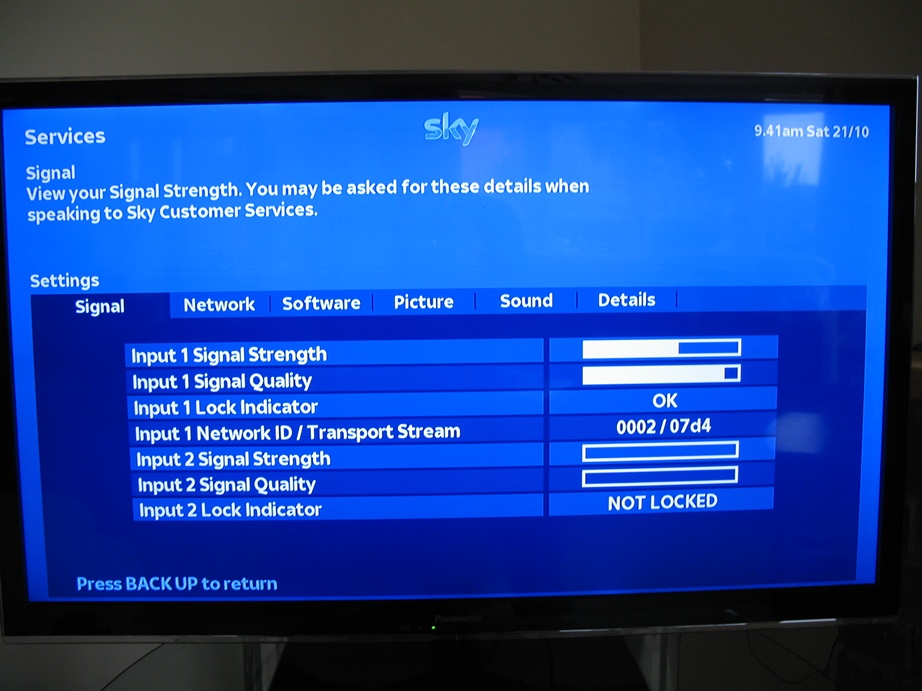

Yes, I found that earlier today. I can take a photo. & post it if you like. Thanks for your help.
Just taken this. I am confused about the bar system.
No signal from the lnb on output 2 suggests the lnb has suffered in the rain. Turn the box off swap the input cables over and if input 2 returns and input 1 is zero then it's new lnb time.

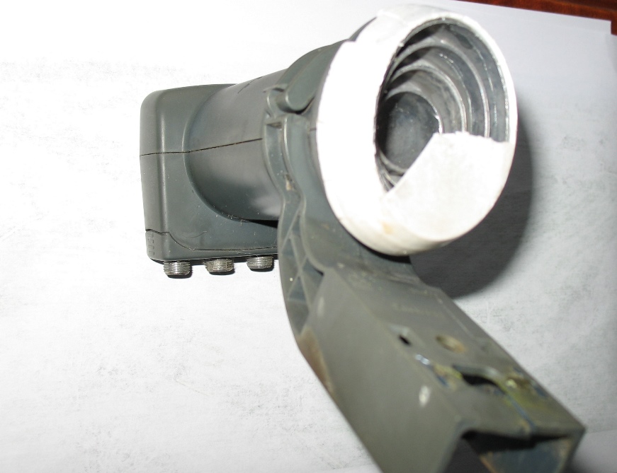

Thank you very much for your help. You clearly know what you are talking about. I had "a man" in today and as you say, it was a faulty LNB that was the issue. As can be seen the cover had deteriorated and allowed the heavy rain to get inside. In fact, after he had removed it I turned it upside down and the water poured out.
