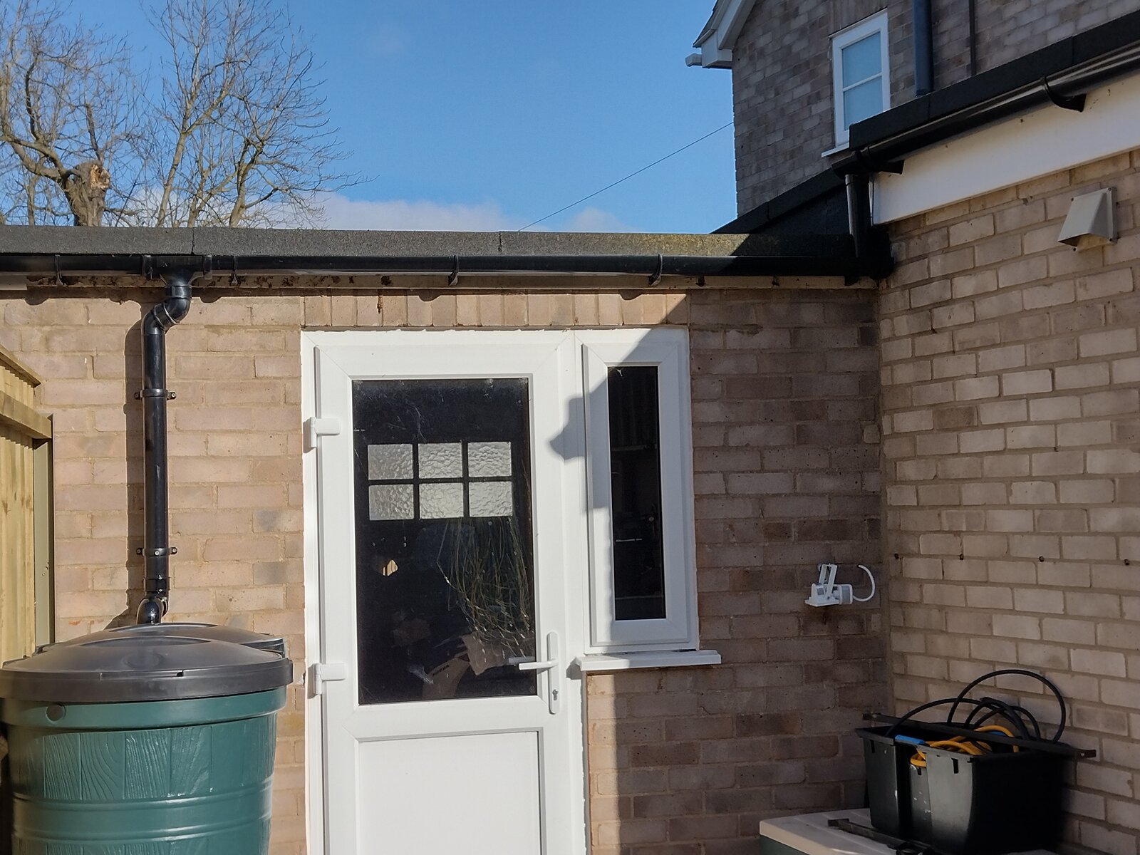

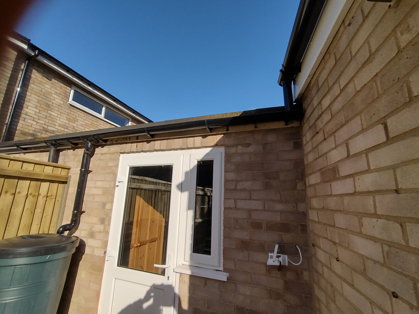

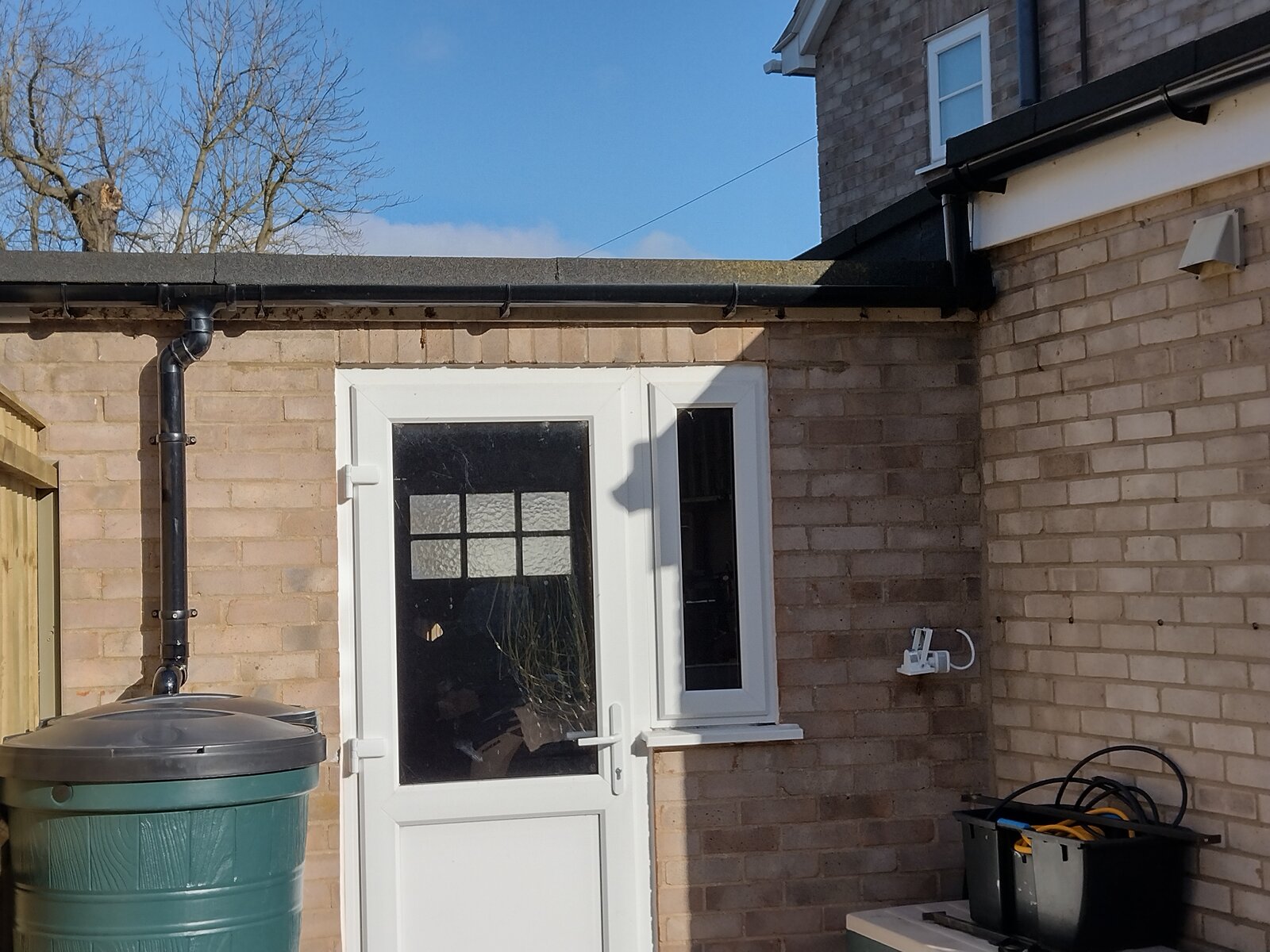

I should have put these up earlier but better late than never.
The pictures show my guttering catches the rain from my flat roof and my running outlet allows water to drop in to my water butt.
The guttering continues over the fence and connects with the neighbours downpipe which also has a running outlet which connects to the neighbours downpipe and into their drain.
I do not have a drain on my side unfortunately and if my water butt gets too full it overflows.

Two solutions I can think of?
Fit an overflow pipe to the butt and (with permission) feed it into the neighbour's downpipe.
It can go through or under the fence, could be fixed to the downpipe with a boss, or just use the open drain if there is one?
Second, simply fit a tap to either the top or bottom of your downpipe.
You'd need to use narrower pipe to find a size available with a valve.
You might suffer freezing in winter if the down supply is full of water?
You could even figure a ballcock into the system that lives in the tank and shuts off the pipe.
Thanks Tigercubrider.
The neighbour says no !
The running outlet is 6.5cm wide from which the downpipe, also 6.5cm wide is fitted so it wont take a narrower pipe for a tap.
I haven't see a ballcock which would shut off a 6.5cm wide supply coming from above the ball cock.
Perhaps you would post a link to one of these if you kwno where I could find one.
How handy are you? I would doubt you could buy a reducer off the shelf so could you cut a piece of plastic of suitable diameter and glue it inside the downpipe. Perhaps glue some 22mm pipe or use a threaded coupler into a hole in this blanking piece to feed a ball valve as others have suggested?
Could you find a local company that has offcuts that you could try with?
