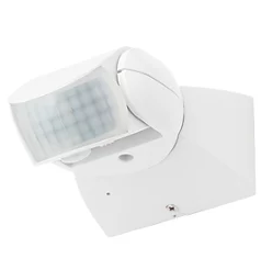

Due to having deeper, high-capacity guttering fitted around my bungalow, there's now insufficient depth on the facias beneath the guttering to refix my original PIR sensors so I'm looking at alternative PIRs. This one caught my eye and would be simple to fix too:
This soffit-fitting style usually have 360 degree sensors (as this example does) and it will be positioned in the soffit just a few inches from the bungalow wall. I can't foresee a problem but thought I'd check just in case. Will a 360 degree sensor cause issues when soffit mounted close to a wall? Thanks.
You mask off the back of the sensor …
As far as I know, the sensor I linked doesn't come with a dedicated fitment/cap to mask off areas (unlike some PIRs I've used) although I could provide masking with electrical tape or similar.
One of these ?
Yes, a very similar sensor to the type I'm looking at. Certainly a possibility.
Believe it or not, I doubt this will fit on the facia board beneath the guttering due to it's depth (not particularly deep I know). It looks very similar to the old PIR I removed which doesn't now fit. I appreciate I could mount it on the soffit but it would look intrusive. I currently use three different styles of outdoor PIR sensors but my favourite type (due to range, reliability, consistency and sensitivity) are these, but they won't fit either:
(I didn't pay £170 for them!)
Seems like there's no big issue with using a 360 degree soffit mounted PIR sensor and I can mask off areas if I find I need to so I'll go with it. Thanks for your input, appreciated.
