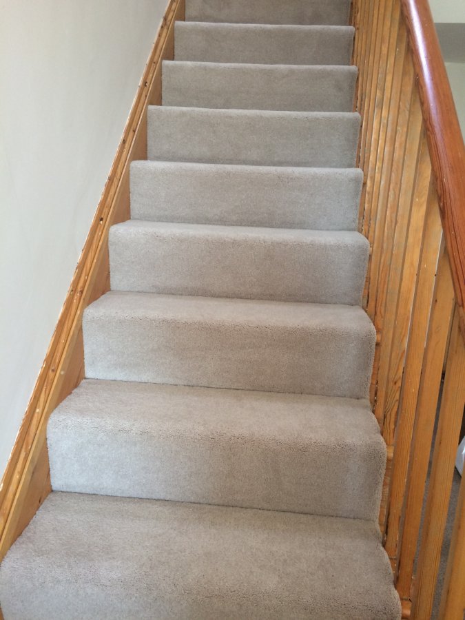

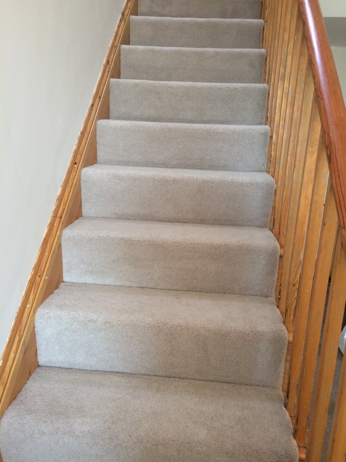

I managed to pick up a lead paint test kit from eBay a couple of years back. The test was like a pen that you scrub on the lead and then it it turns red, lead is present. I removed all the paint on my stairs with a Bahco scraper, was much easier than chemicals or a paint stripper. Just gave me RSI for a time afterwards!!
I've seen the scrapper technique. Was it easy? Looks like it creates alot of dust no? The videos they're all in hazmat gear with respirators which the area plastic contained like something out of E.T. :D chemicals are good as they don't create too much dust but are slow.
Yes the scraper was easy, i got through a few of the spare blades. I tried the heat gun on a piece of skirting that had been removed and it was a slow process. I only had the original paint and a coat of white gloss to remove. The paint came off in flakes. Here is the finished stairs
looks good! I might try the scraper on the cupboard wall paint as not sure how the chemical would react to it. Did your paint test positive for lead in the end? Van you remember how much the kit cost?
Yes, I had lead paint, the house is from 1890 ish so lead paint and old gas lights!!! Luckily it had only been covered by one dodgy coat of white gloss by me about 20 years ago so there wasn't to much to remove!
The test kit was about £6/8 ish, under a tenner for sure. I got it from eBay.
