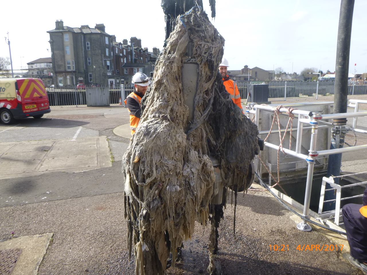

This is what they look like when the accumulate in the system....
