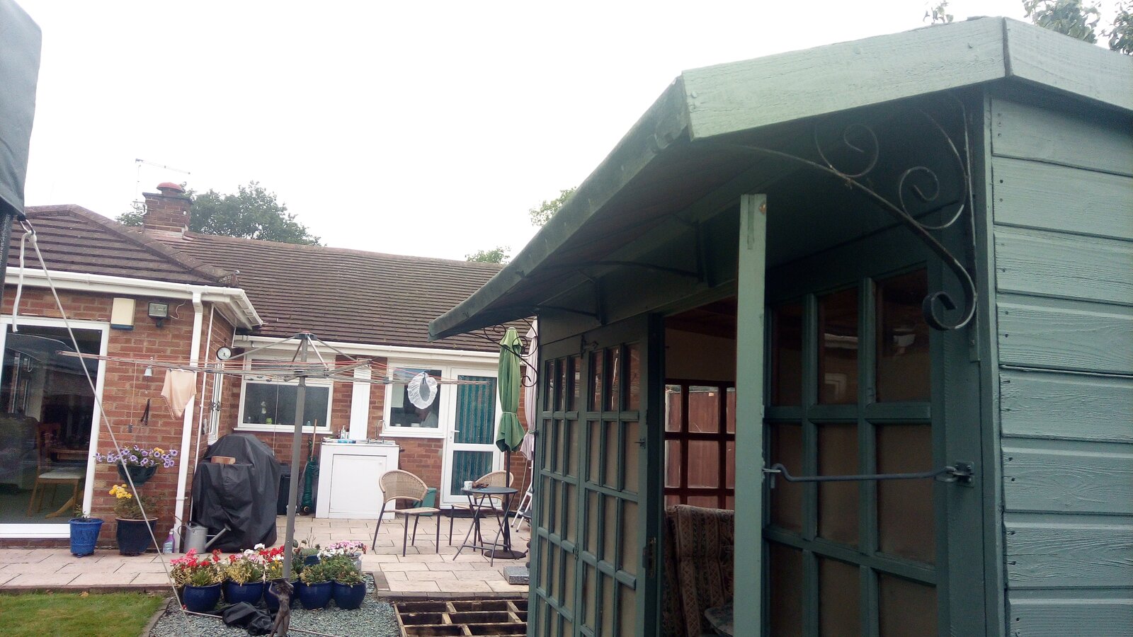

Hi, anyone got any ideas on how to fit guttering to my summerhouse overhang roof.
I have seen plenty of advice on fitting guttering to sheds etc. but these all refer to fitting along the side.
My summerhouse has an overhang roof and the gap between the top of the door and the roof is quite small, the weight of the overhang causes the roof to drop slightly at overtime and then it need to be supported further so the door doesn't catch on the roof brackets.
Just replacing my decking with composite and all the joists and noggins in front of the door have rotted where the rain has poured down on them.
Any suggestions welcome.
Any pictures, (both close and distant), of your summer house?
It may give people more of an idea on what to suggest.
I'm thinking, if you removed those central brackets, (and probably the end ones to assist), then jack up the over hang a bit with a couple of acro props, could you reverse the central brackets to give a higher lift and then move the outer brackets up a bit to suit? Or maybe some other form of bracket?
If you get your guttering up you will need a downspout at one end to help prevent the new decking getting a soak each time it rained.
