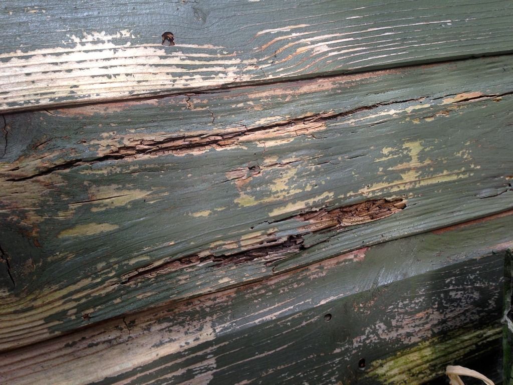

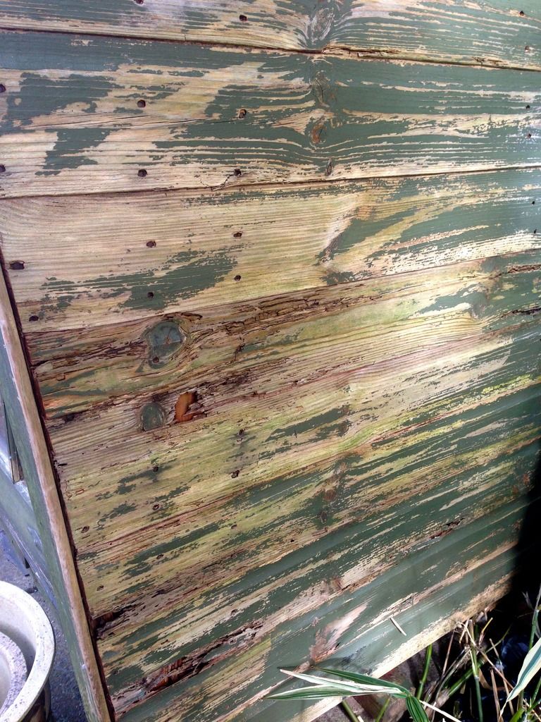

I have the same problem, I've cut down an overgrown bamboo plant to discover it has rubbed against the summerhouse and worn it away.
Seeing as the damage is in the lower half of the shed, I assume I need to remove the boards from the bottom up and replace?

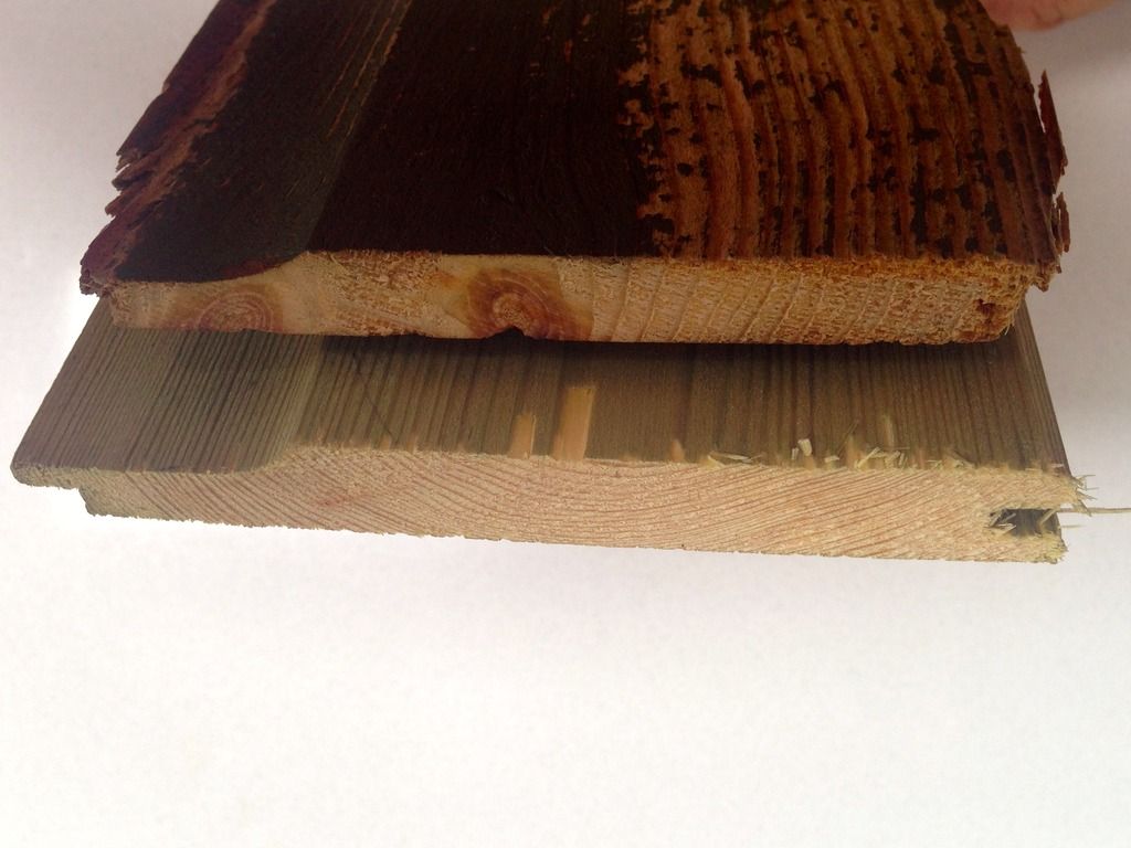

Also, where would I get boards to match and what are they called? Heres a profile view of the end of the boards...

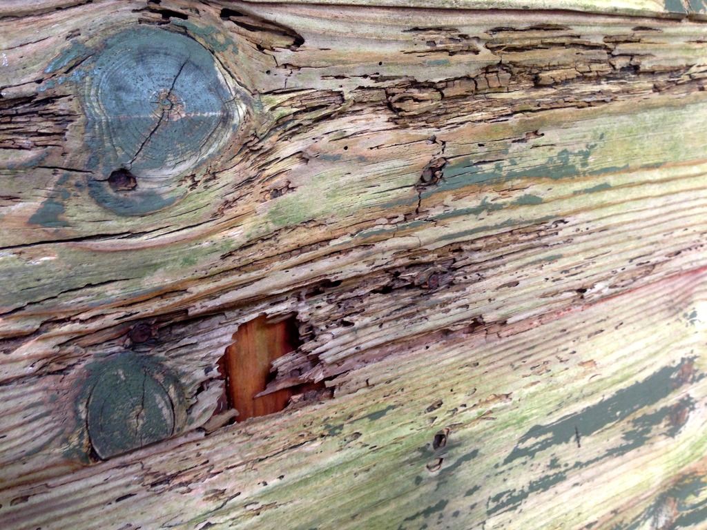

looks about 6 or 7 planks shot from that picture
you can take wood thats fully exposed without treatment off any sort will last for years regardless off quality
wood can get wet very wet soaked over several months as long as the moisture content is constantly changing over quite a range it will not be effected
its around a constant19% the damage happens this can be debris at ground level 'a contact point with another component that will trap moisture or indeed a plant i suspect in the shade holding moisture
this is why you seldom get rot on the side the sun gets to as the moisture level varies far greater than in the shade
I removed the lower panel from my summer house today and cut a section from it to take as a sample to a local local fencing company. The panel came away easily when prised off with a wide bladed tool. They sell an almost identical board and gave me a sample to bring home to compare with my summerhouse. Thankfully it fitted just one so I'll be going back to buy a few from them..
