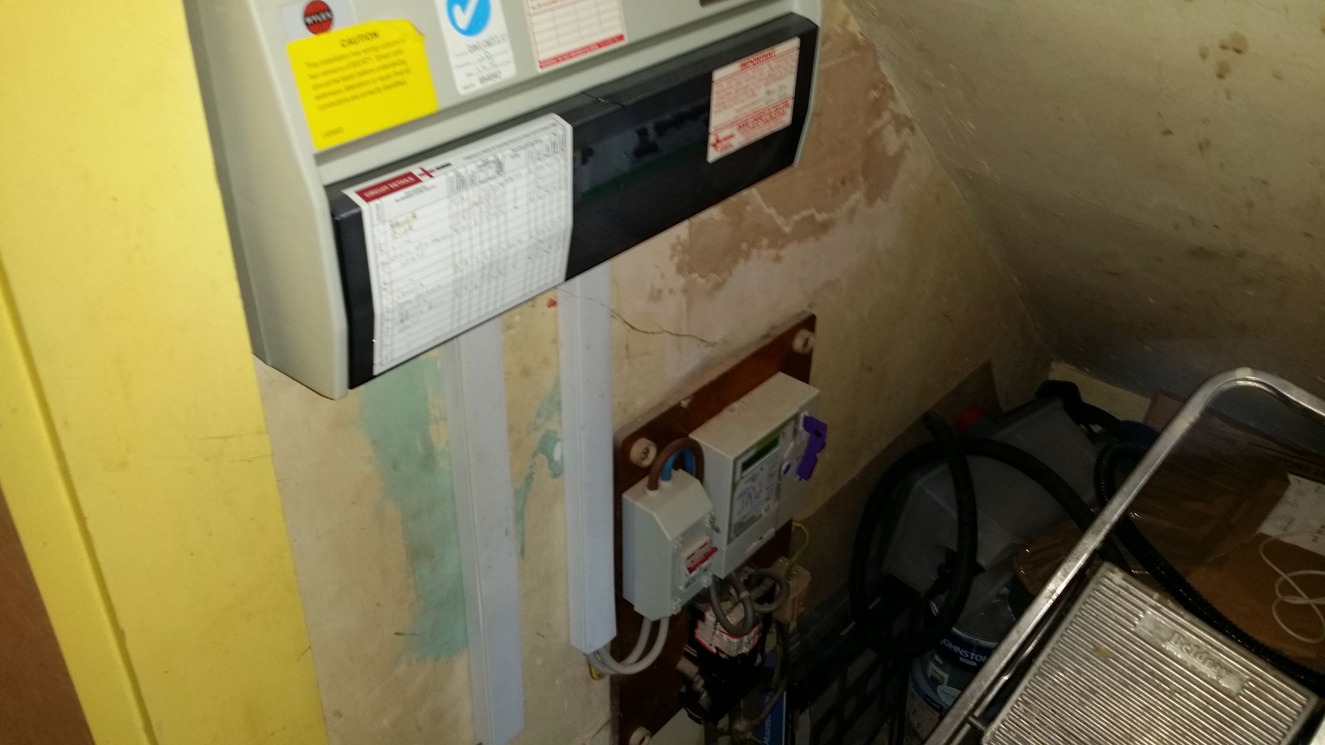

Before I start Im not going to attempt to wire into the mains myself! I know how to wire a ring and lighting circuit but no way am I confident to play with the mains or risk the house!
Im intending to start building a summerhouse/workshop in the next month or so and wiring it for electric.
The summerhouse is going to be my escape at the end of the garden when her indoors gets on my case! :rolleyes: I also would like to use it for entertainment. Electrics wise in the summerhouse it would have 2 ceiling lights, 9.5kw water heater and a ring consisting of maybe 4 double sockets to run a tv, stereo and what ever other crap I will end up plugged in!
The workshop part would have 4 double sockets and 1 ceiling light. Wattage is a hard one to guess as with power tools it could be a few hundred to a few thousand watts!
Now you have what I want to do I'll give you the questions!
I've read from other threads on various forums I'd be best putting a switchfuse from the mains supply this for example http://www.screwfix.com/p/wylex-100a-switchfuse-100a-cf/60830
Run some armoured cable from the house to the SH/WS thickness depending on the electricians calculations, and connect to a consumer unit like http://www.screwfix.com/p/wylex-11-way-fully-insulated-main-switch-consumer-unit/26208
How 'correct' is this?
Would these be the correct parts for the electrician if I was to purchase them for him?
The summerhouse /workshop will be approximately 50ft away from the house if that makes any difference?
Am I correct in thinking I can install all electrics in the SH/WS and then get them passed off by the electrician and he just hooks up the supply?

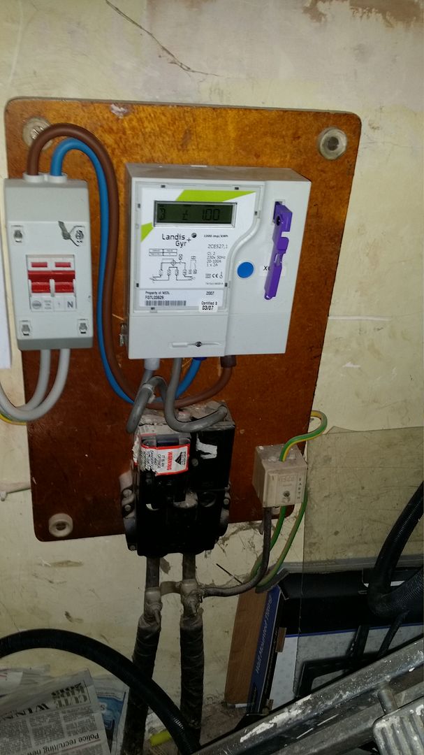

Attached is a photos of the house supply etc
You really need to discuss it with your electrician.
There are a lot of variables which are not worth commenting on if they don't apply.
You could search for previous similar threads.
Possibly, however if someone else is installing, DO NOT buy parts in advance, as they are likely to be the wrong ones, not required, not liked by the installer etc.
Distance makes a big difference, as does the intended load.
Why do you want a 9.kW water heater in there - this will require substantial sized cable and could overload the existing supply.
No. If you want to install some/all of it, you must discuss this with the electrician before doing anything.
Installing things and then contacting someone later will not work - such as when the electrician arrives and discovers various problems, and then cannot 'hook it up' without substantial alterations to what you have already installed.
Whether earth rods, switchfuses, ring circuits and other items are needed or not is something you must discuss with the electrician.

Thanks for the reply.
The water heater is simply is simply for that! Its the lowest watt Ive found for instant hot water supply rather than have a small tank... I intend to have a little bar area so dragging dirty mugs, glasses etc to and throw doesnt have much of an appeal to me.
I was thinking the electrician would probably put a henley block on the meter tails and supply the switchfuse from there to the CU in the SH?

If you could manage with a little 3kw handwash unit like this instead of the 9.5kw water heater, you'd then be ok with a much more reasonable size of supply and cable. http://www.tlc-direct.co.uk/Products/TTT30slash3.html
It's quite likely that the main supply to you house isn't up to the job for that much additional load.
