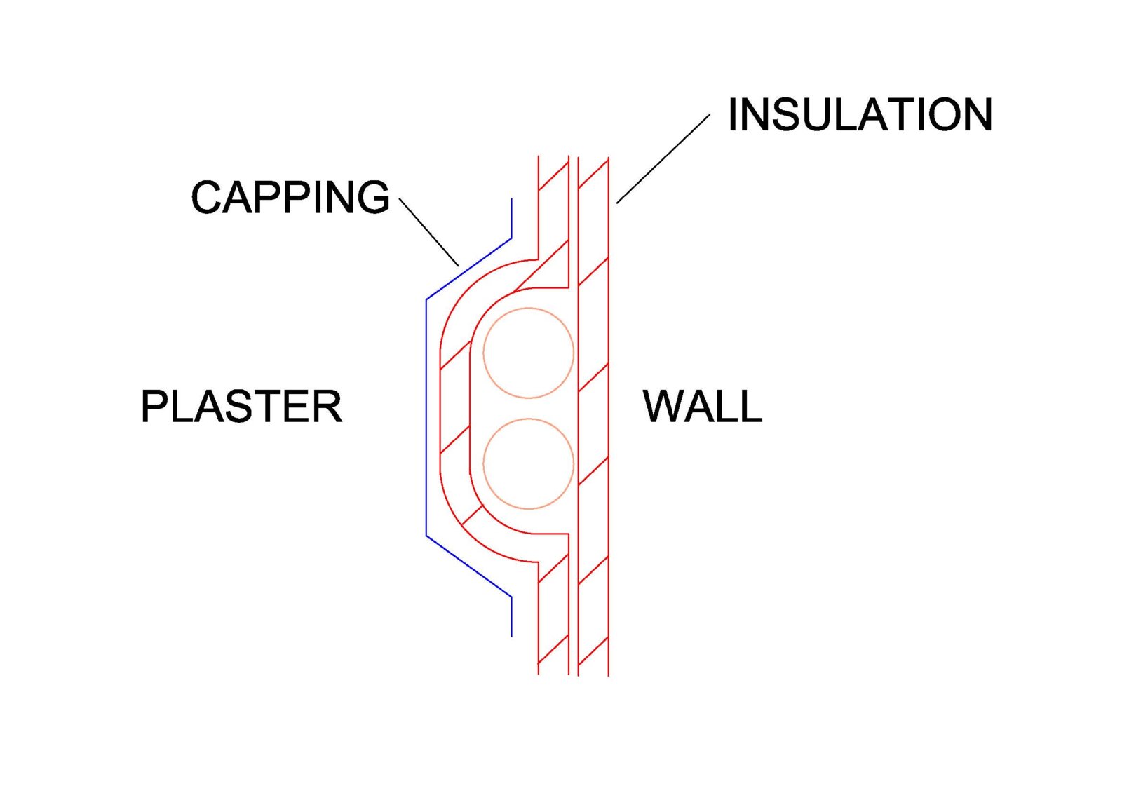

In my parents 1981 built bungalow, the pipes run down to the radiators from the ceiling and are covered with a layer of thin insulation between the wall and the pipes, and also on top of the pipes. Then the pipes and the insulation are covered with cable capping and plastered over. There have never been any cracks since it was built.
Hi , thanks for replying. What do you mean when you say “thin layer of insulation”?, also ,what’s ‘cable capping ‘?
Sorry to be a pain

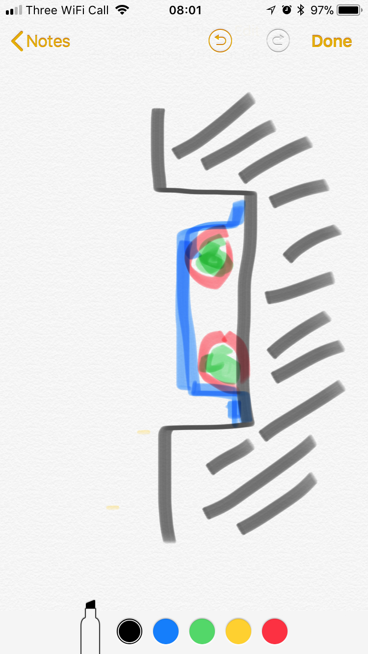

Hi, Does it look like the attached file in cross section?
Green- pipe
Red insulation
Green- channel
Black - wall

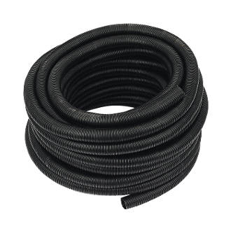

Over the years,Have seen a lot of serious defects where pipes are buried in walls. Plaster/render cracking is usual but have also seen pipes leaking due to corrosion and friction where the copper pipe expands/contracts against rough masonry.
If pipes have to be buried in a solid wall,then they should be in conduit and have pipe/cable detecting foil attached.All available from johnguest.
It is more like this. Wrapping the insulation around the pipes would probably make it too thick for the plaster and capping to cover. I seem to remember that where the pipes are fixed to internal walls, there is no insulation between the pipes and the wall.
