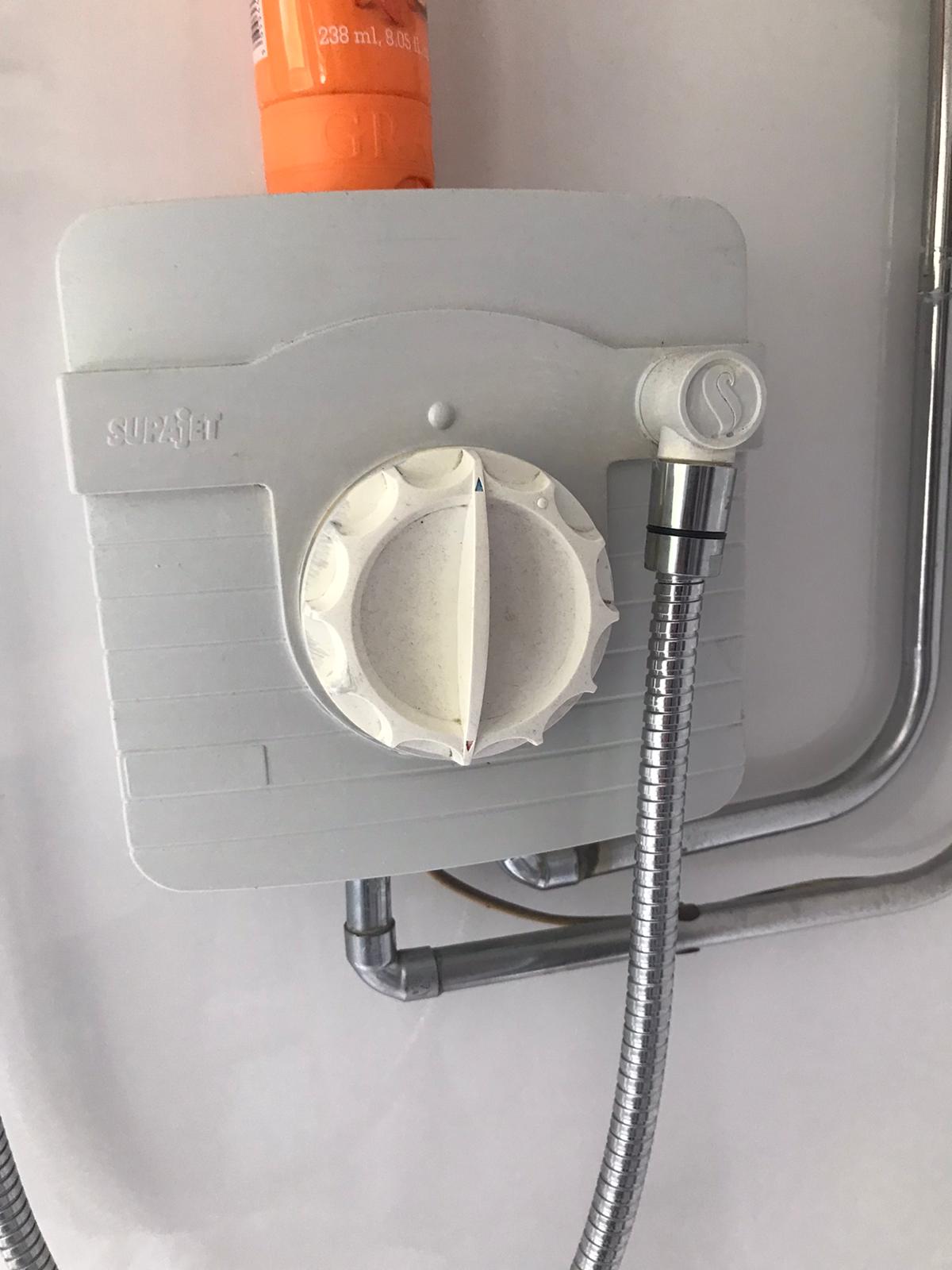

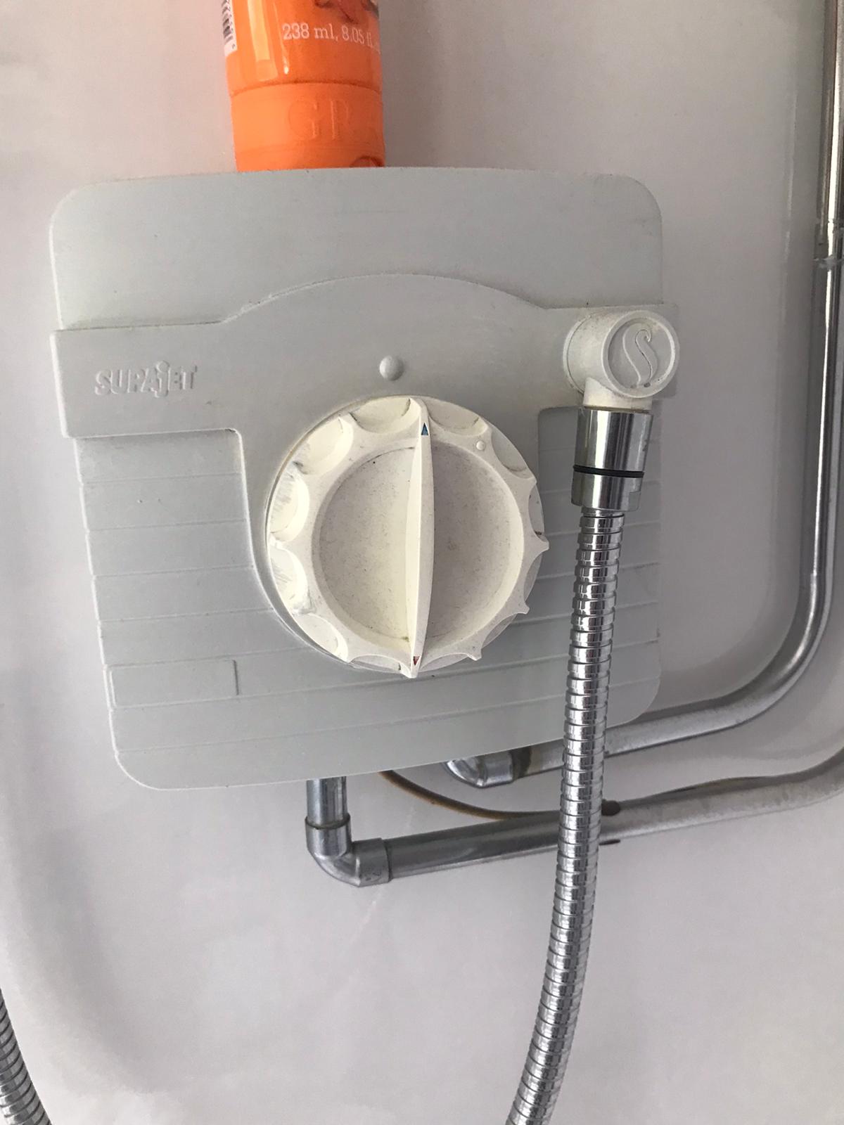

Could anyone help identify this shower? Is it power shower? Any recommendations for an easy replacement?
Thanks!
yes its s power shower this will replace it
