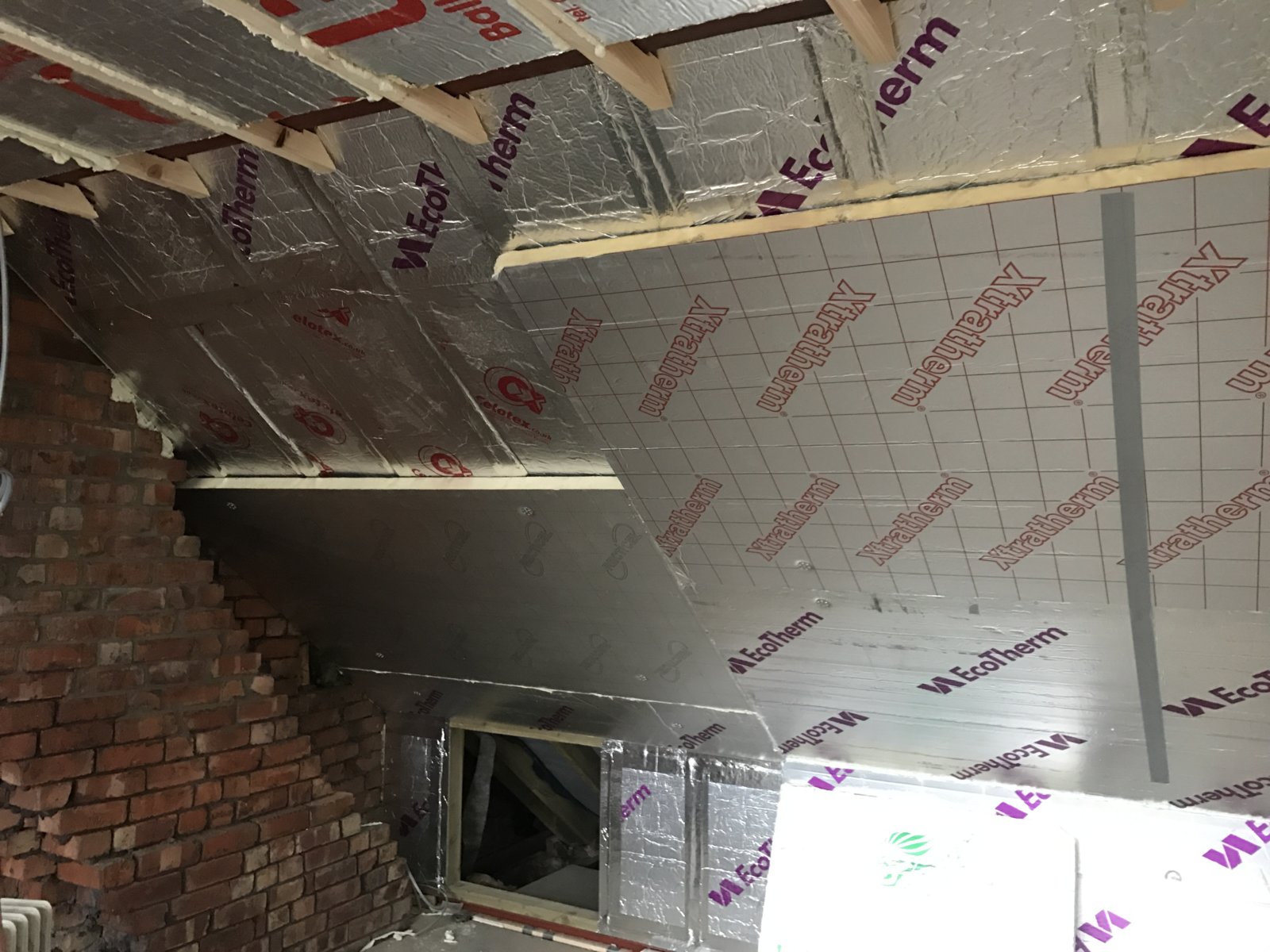

If this an upgrade and not subject to Building Control then 50mm celotex between and then a continuous 25mm layer beneath, no need for any battens. Not ideal but better than a kick in the Nads!
Great thanks. No we’re not bound by regs as it’s just a refurb. We have checked with the council. However we want to do it as close to regs as poss. Do you mean a continuous 25mm of celotex?
Isover is a mineral wool material; it has about half the thermal performance of a board like celotex for the same thickness. On the other hand it will be better at absorbing sound, and lets moisture through.
If you want the most thermal benefit with thr least loss of headroom, celotex or equivalent would be a better choice.
He means like this:
Some between the rafters (rafters are covered with foil tape there), then a full layer under them.
