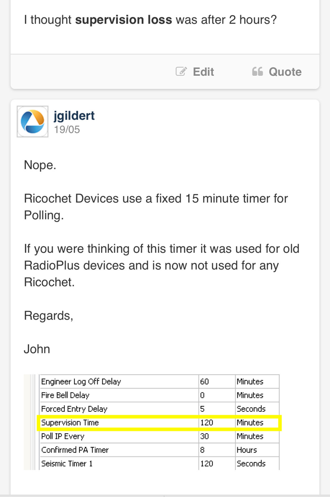

This info is from Texecom’s technical guy. Got to say I’m confused by this.

The panel reports supervision fault after 2hrs not 15 minutes. You can test this for verification, it certainly was the case on Elites that I have seen, however I can't claim to have seen them all and verify it.
Technically if the device doesn't poll in it is lost, but the panel does not report as lost (supervision fault) until missing for 2 hours, not checked this lately, had a look at the manuals just now, the expander manuals don't really mention it.
32 - Supervision Time
This timer controls the frequency at which the Ricochet devices are
required to report in to the control panel.
Supervision Fault
A Radio device has failed to poll back to the panel within the Supervision Time
Never tested the supervision time on Radio plus or Ricochet, but my understanding is the timer is fixed these days, but can't say that with any degree of certainty.
I don't doubt your correspondence, until I physically see different, I will believe the panel showing supervision fault has had a device not poll in for 2 hrs not 15 minutes.
It maybe possible on the ricochet diagnostics, that an S will show that a radio device has not polled in but two hours has not expired and the panel not reported a supervision fault.
I have seen the display go blank when a device hasn't reported in on the ricochet diagnostics, but haven't tested to confirm at which point that occurs.
