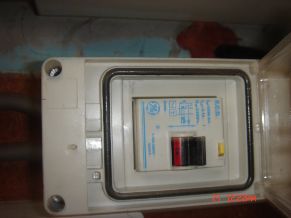

Thanks PBofD,
The fuse board is MK brand, Pt No LN5500s 100A to BS spec 60 439-3 which you can just about see in top left corner of the picture. The first MCB (No 1) on the right is 32A for the hob (partially out of the pic) but can be seen in the third pic. Items 3,5 and 6 are not in use. I have also included pics of RCD and one showing the whole setup with different colour cables on the third pic. I was told that because the two colours of cables (grey and white) are obvious, there was no need to label the fact.
I hope the pics below help.
You can still buy rbo's for the board. You have not actually added any circuits ? You have moved a socket and replaced a damaged one. If you add a circuit or a socket the addition should have RCD protection.

Yep, RCBOs will still be available.
