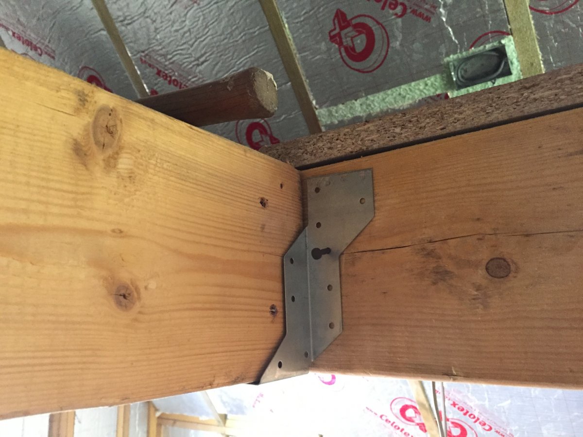

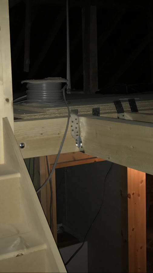

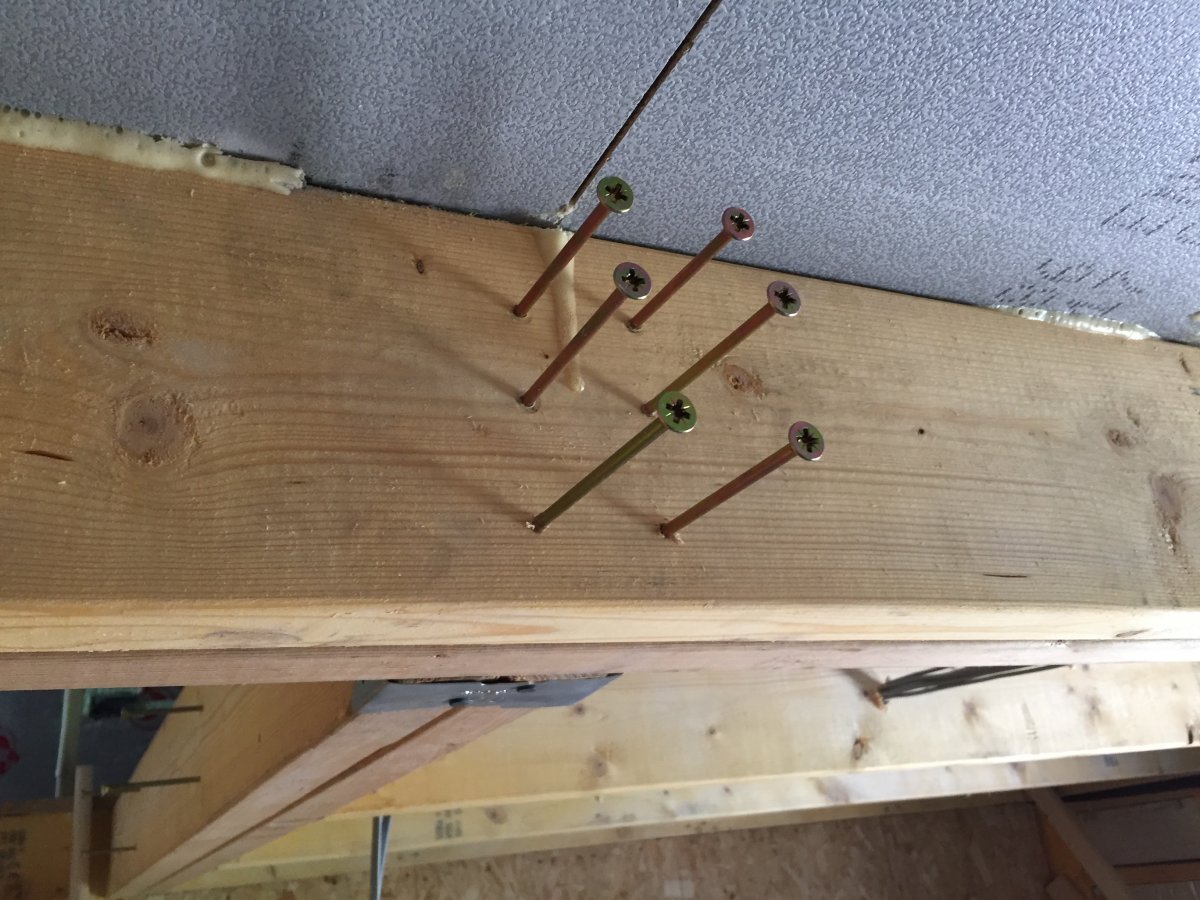

I went fur both then 200mn screws in the ends and hanger as well.
I'll finish with the twisted nails mentioned above.
Just for clarity it is all under building regs as the whole structure is new. The Mezzanine was an after thought as we thought it was dead space so we opened it up but didn't allow for access. the plan was to just use a ladder but now we want something more permanent hence the cut through.
Stick a few more nails in the hangers, and you'll have a good belt and braces job there (otherwise it'll just be consider for show). Now what about the joists going from the trimmer.
Looks good, exactly as I did mine but with a couple of extra screws
