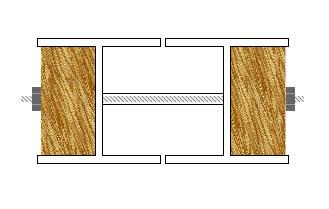

I am going to do this the hard way by hiding the UBs in the floor space and hang the 1st floor joists from timber inside the beam. The beams have arrived today and WOW aren't they heavy. The suppliers have burnt 12mm holes at 600mm centres down the beam, they need a little bit of tidying up but that's no hardship. As I'll be bolting timber inside the web of the beam, do I need to drill more holes in the web purely for fixing the timber inside it or can I use the existing 12mm holes?

12mm holes at 600 centres is fine for bolting the timber into the web - the bottom flange will be taking most of the weight, while the bolts just hold it in position.

The existing 12mm holes at 600mm centres are for bolting the two beams together. Can I do as per below?
With regard to bolting the beams together, you need spacer tubes in between them. Something like 50x50 SHS which will stop the flanges of the beams wanting to slide over one another as the bolts are tightened. Or if the beams are not tight to each other it will keep them the correct distance apart.
Not sure if anyone answered previously but yes, bolt the timbers to the webs as shown on the pic.
I did try and illustrate the spacer tube when making that image, should have noted it up too :)
