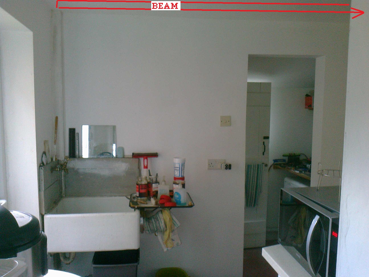

Hi,
Where do I get calculations for a beam (RSJ) that I want to fit in place of a supporting wall? It supports a sloping roof, see photos.
Also for lintels for french doors, I want to fit.
Structural engineer or if your happy doing drawings catnic have a scheduling service

The lintel for that second picture I'd expect they'll want it pocketing into the wall.
The left end will need a column to sit on at least, otherwise it's just floating in the air unless I'm missing something?

Does the floor level drop down inside?
Why are you showing two doors in close proximity to each other?
The proposed column of masonry, left remaining (after those doors are knocked out) is way too small. It should be a minimum of three bricks in each direction.
It's not just about the beam or lintel, but also the walls and foundations supporting the beam or lintel. The likes of Catnic won't normally consider any thing but the lintel loading.

Removing the internal wall, which may not be touching the rafters (I'll investigate), will leave a wall both sides. If a lintel is needed, I wanted to know if I could use wall hangers.

The floor has been raised over the years to be higher than the damp course, and I had to cut round it, and water froof it when I first arrived. I could drop it down to original, which will suit the french doors better, but will leave a step down in the kitchen. (As originally)
Where you think I want a second door, is where I want a window. There used to be a door there, before I filled it in. (coal shed)
I understand what you mean regarding the building regs and the window, next to the door, but the previous door has been there for 100 years+

I spoke to the building officer, and most of what I want to do has been agreed.
If you look at the 1st photo in #1, left window. It is supported by the wall plate. This won't be acceptable for a 2ish Mtr window.
It would be better to keep the height if possible, and the only way I can think how to do it is an 'L' shaped lintel for a 9" wall to support the plate without much loss of height.
Any ideas please?
