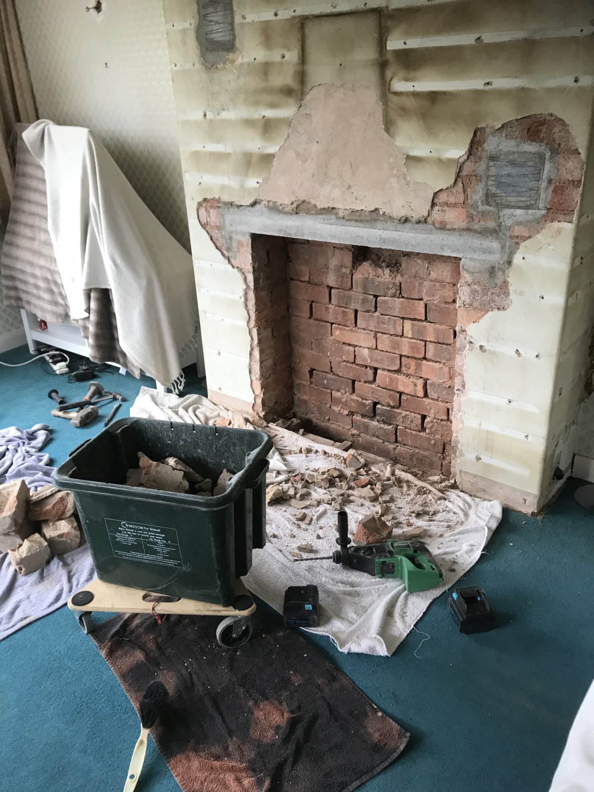

I have a 1960 bungalow with a brick built chimney
There was never a real fire installed just a few bricks removed for a gas fire flu
I want to open it up for a burner.
There is no gather behind the opening but a second course of bricks in front of the rear wall. This second course holds up the chimney section bricks that are at right angles to it they are three bricks wide end on (350mm) each side of the chimney hole.
I would have to remove this second course of supporting bricks to 900mm high to get the depth I need for a burner, which means I have to think about supporting the chimney section between the front lintel and the rear wall.

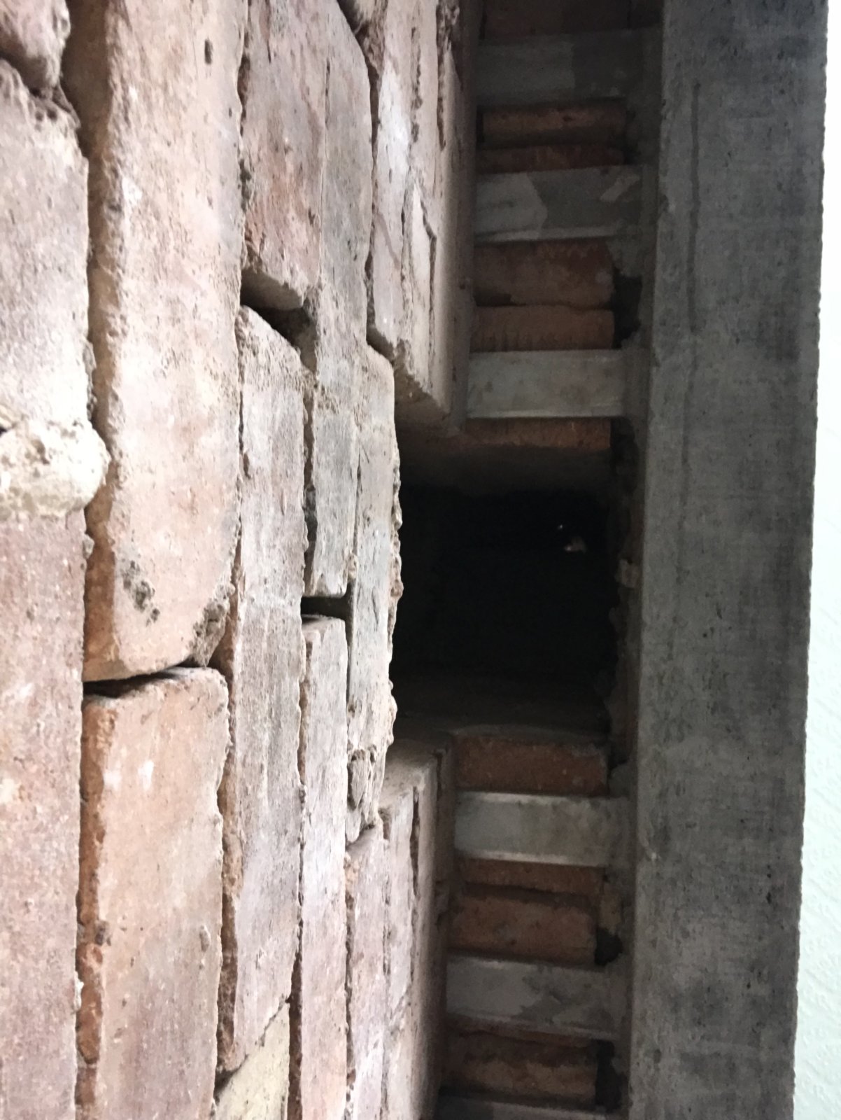

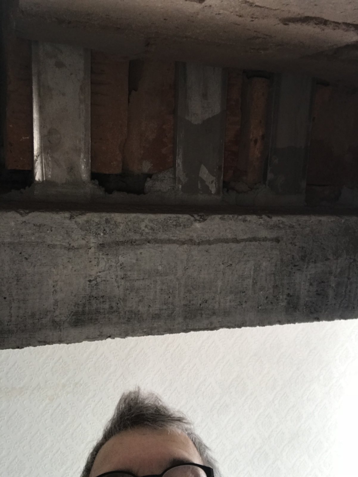

So a HETAS engineer called round for a very reasonable charge and said he would be happy to sign off my design.
I have gone ahead with it and it worked out well.
