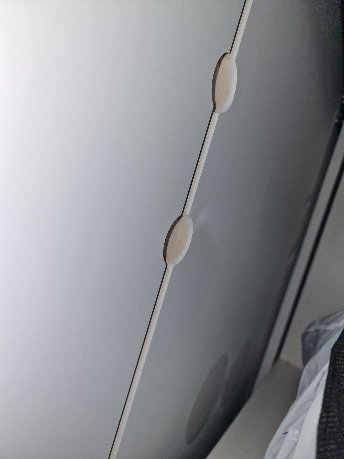

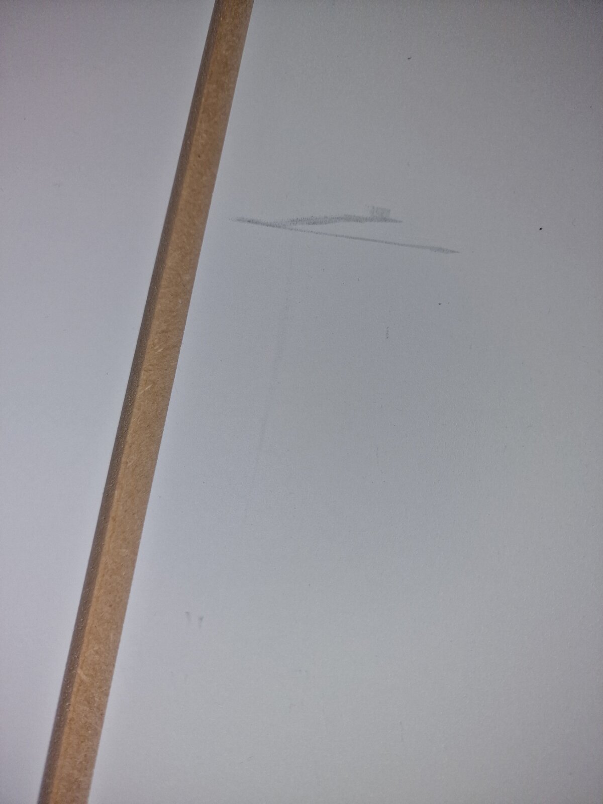

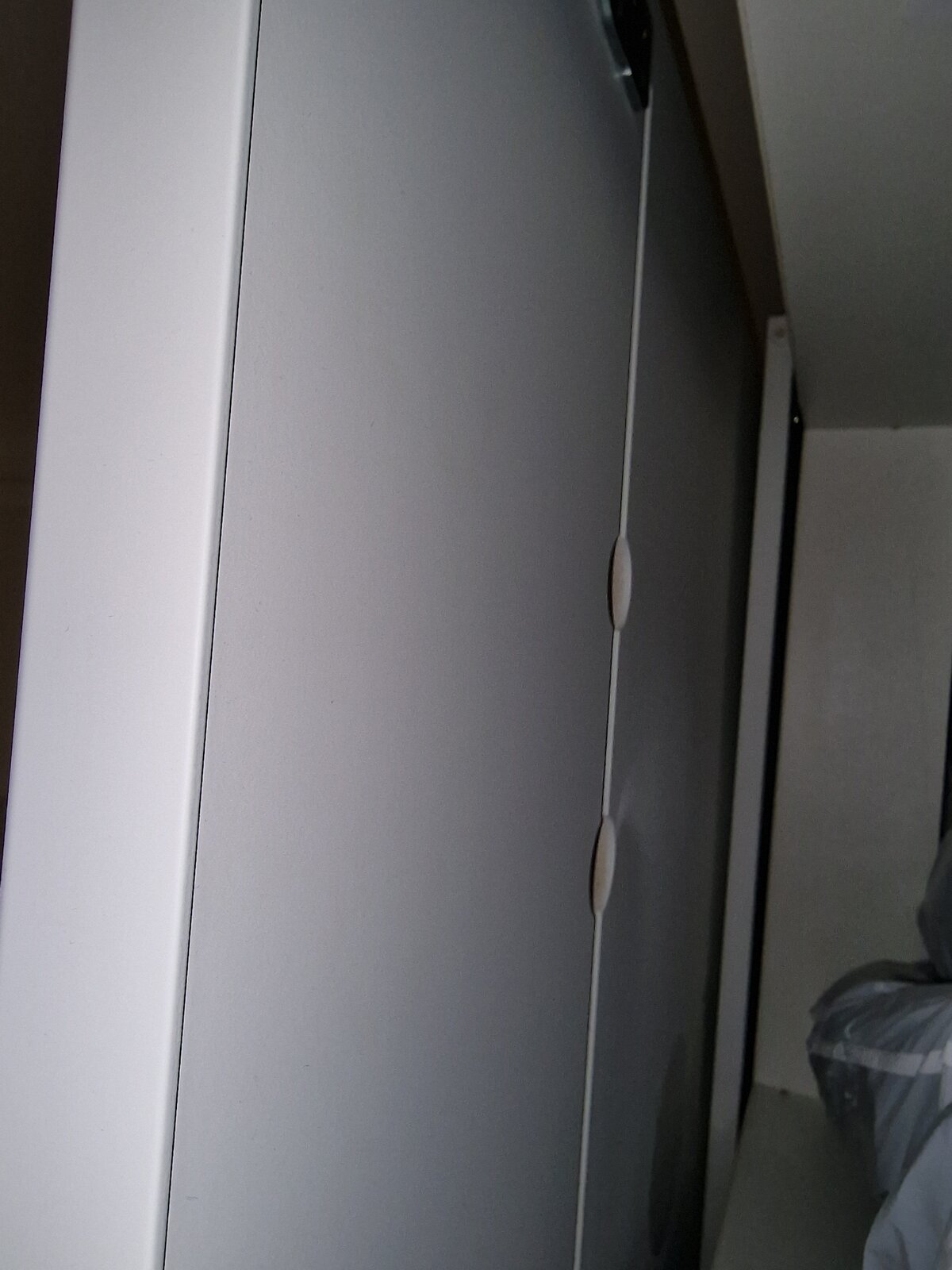

My joiner left a wardrobe project unfinished. He had said that he was going to put supporting rods behind the wardrobe doors, which are basically three 3m tall sliding doors.
I haven't found on google something that classifies as a wooden panel supporting rod, I don't know if he had something specific in mind, or a general rod?
I'm attaching a few pics that show the routing as well as some points that I presume would hold the rod in place.
Right now the doors are bent (some more than others) and I suspect that's the reason he wanted to put the rods in the first place. Not that I trust what he'd said now, but hey ho, I thought I'd run it by this forum.
They certainly exist
eg
or hafele do one called planofit
They need a 35mm hole and some grooves
eg
This should be it! He provided a lot of stuff from Hafele, so this should be it. Many thanks!
