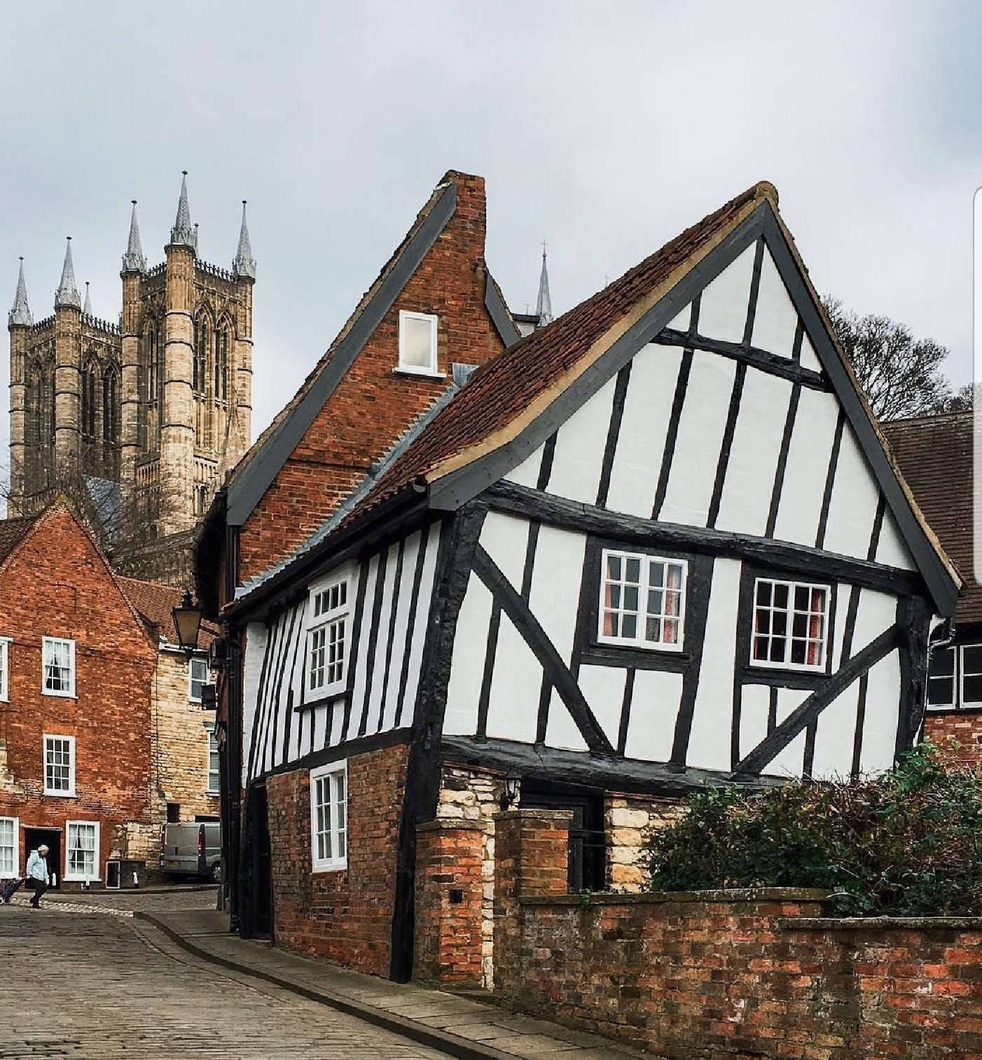

ours were built off the floorboards, but most of them the floorboards have shrunk and dropped, but the wall is sticking where it is somehow.
Tbh the ceiling joists are all over the place on mine (60s) anyway, like 10mm out between adjacent joists, and it’s not just down to the odd masonry wall above. The joists look chunky but I reckon they’re over spanned.
