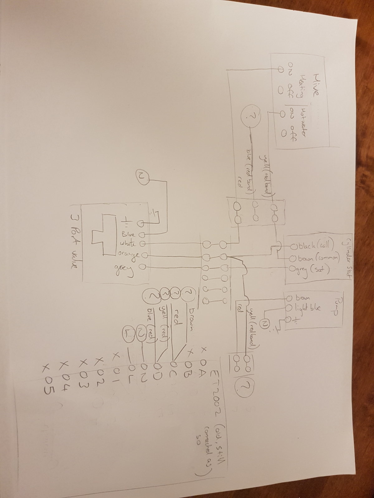

I am just at the stage where I am drawing the wiring out on paper to see if there is a mistake somewhere but because of the initial operation of the old programmer I thought I best check here first.

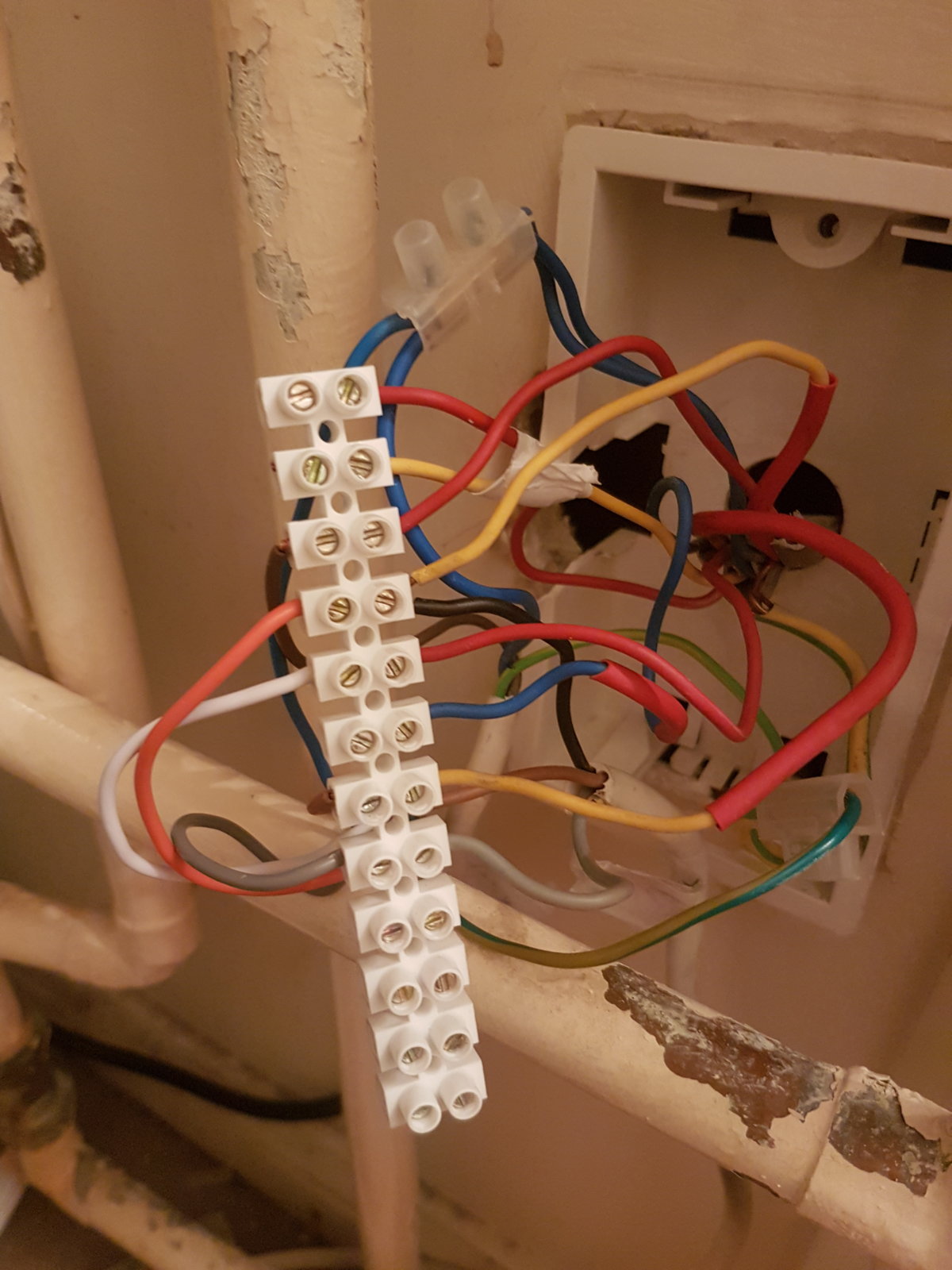

I have traced as much out as I can without taking the boiler to bits or messing around with the cables that are still attached to the junction box side of the old ep2002. Image attached. A couple of those cables may be from the thermostat that I have linked out
The terminal block cables are as follows
1 x red (old thermostat)
2 x yellow (old thermostat)
3 brown (pump) red?
4 orange (3valve) yellow?
Black (cylinder stat call)
5 White (3valve) red (heating on from hive)
6 x blue red tag (always live)?
7 brown (cylinder stat com) yellow red tag (hw from hive)
8 grey (3 valve) grey (cyl stat sat)
I'm really stumped, does the boiler decide to run the pump? There is a cable that goes out of the junction box upstairs to (I assume) the boiler, one cable runs the pump, one starts the boiler and one is the neutral...
I have spotted that when the boiler is idle the lamp is a steady orange
When I call for heating the boiler light flashed green and orange, lights for about 2 seconds and goes off then goes to a flashing green
Could this be because of the odd voltage on the cylinder satisied ggrey cable?
Sorry to put this on you, I really approximate any help you could give me
Steve

You are missing the hot water off connection from the hive to the grey on the valve. Yes gravity mode will get it going. It looks like someone has stolen the hot water off wire to use for pump overrun. Had this same fault on thursday, I ran another cable in.
I see, thanks for that Echo. I will try and see if there is a spare cable up there and wire that in to the HW OFF. Do you think that this would be the cause of my motorised valve not going to hot water only position?
Steve
The valve should move to the HW only position if there is no power on the valves grey and white wires, it is pulled to that position by a spring inside the valve.
If there is power on the white wire the valve moves to the mid position.
If there is power on the white and grey wires, the valve moves to CH only.
your wiring looks ok from the photo. The boiler controls the pump. To get you going set the Hive to gravity mode, this should allow the heating to work.
When only Hot water is selected, if the cylinder stat is calling for heat it will send power to the boiler to run, as the cylinder call connection is connected directly to the boiler run connection (via the connector you have marked ?) there will be power on the valves orange wire, but this does not control the valve in any way.
If HW is selected and the cylinder stat is not calling for heat the valves grey wire should have power, again the valve will do nothing.
