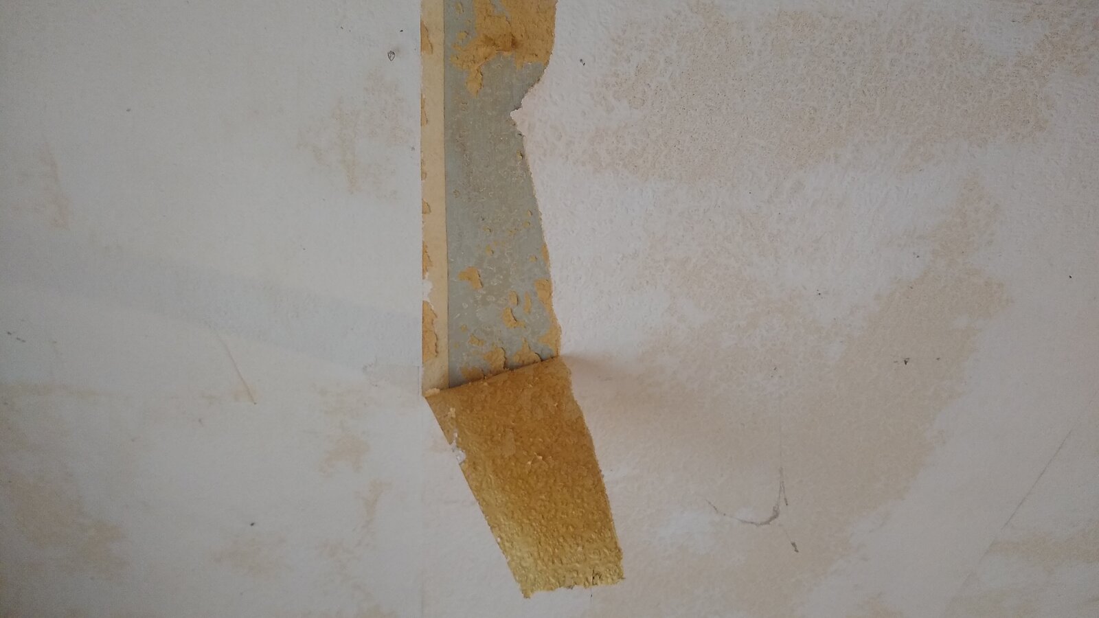

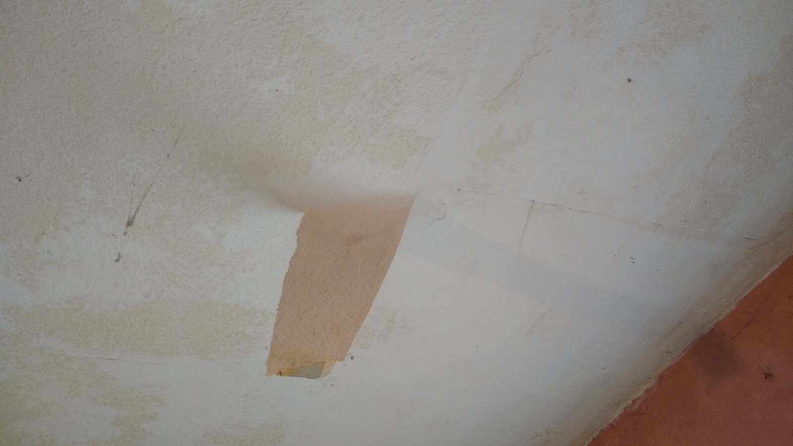

I am a textured ceiling which appears like artex
However, upon further investigation it actually appears to be textured wallpaper on a lath and plaster ceiling
If this is the case, am i right in saying that it can't be asbestos?
Or should i get this tested? (at a cost)
Yes just looks like textured paper to me.(y)
I have heard scare stories about asbestos in wallpaper but I think they are just that stories.
Maybe very old Lincrusta types might be suspect, but not normal blown vinyl, woodchip or embossed papers like yours appears to be.:)
It's likely to be a bitch to remove dry. Buy a £25 steamer and it will be so much easier
