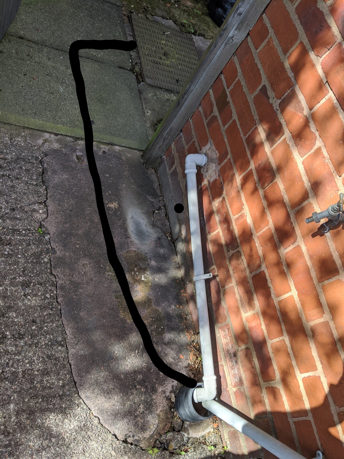

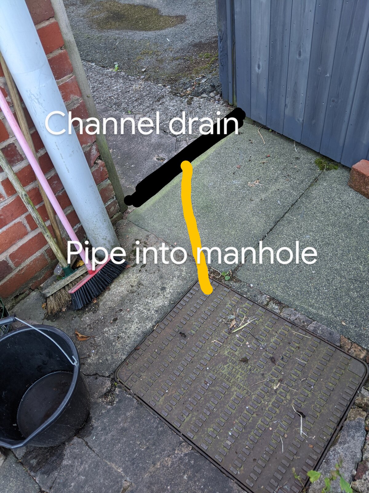

During the heavy rain this week I noticed that water from the driveway is flowing to the rear of the house and to a gully on the opposite side.
I am planning on installing a channel drain and guild the water to a sewerage manhole nearby. Any issues with doing that?
Very similar to what is done here https://mobile.twitter.com/TheDrainPeople/status/1182724604030312448/photo/2

As far as I can tell the, water from the down pipe in the picture is already going in the same manhole.
Is the water from your toilet going through this manhole too?
Get someone to flush some bog roll and watch for a few minutes.
Find out if its a rain water or a foul water manhole. And also if it is your manhole (just serving your house) or the water company's (other pipe rrom neighbours passing through it).
If its a surface water drain or combined system its OK, however if your property has seperate foul and surface water systems it should not be connected into the foul water system.

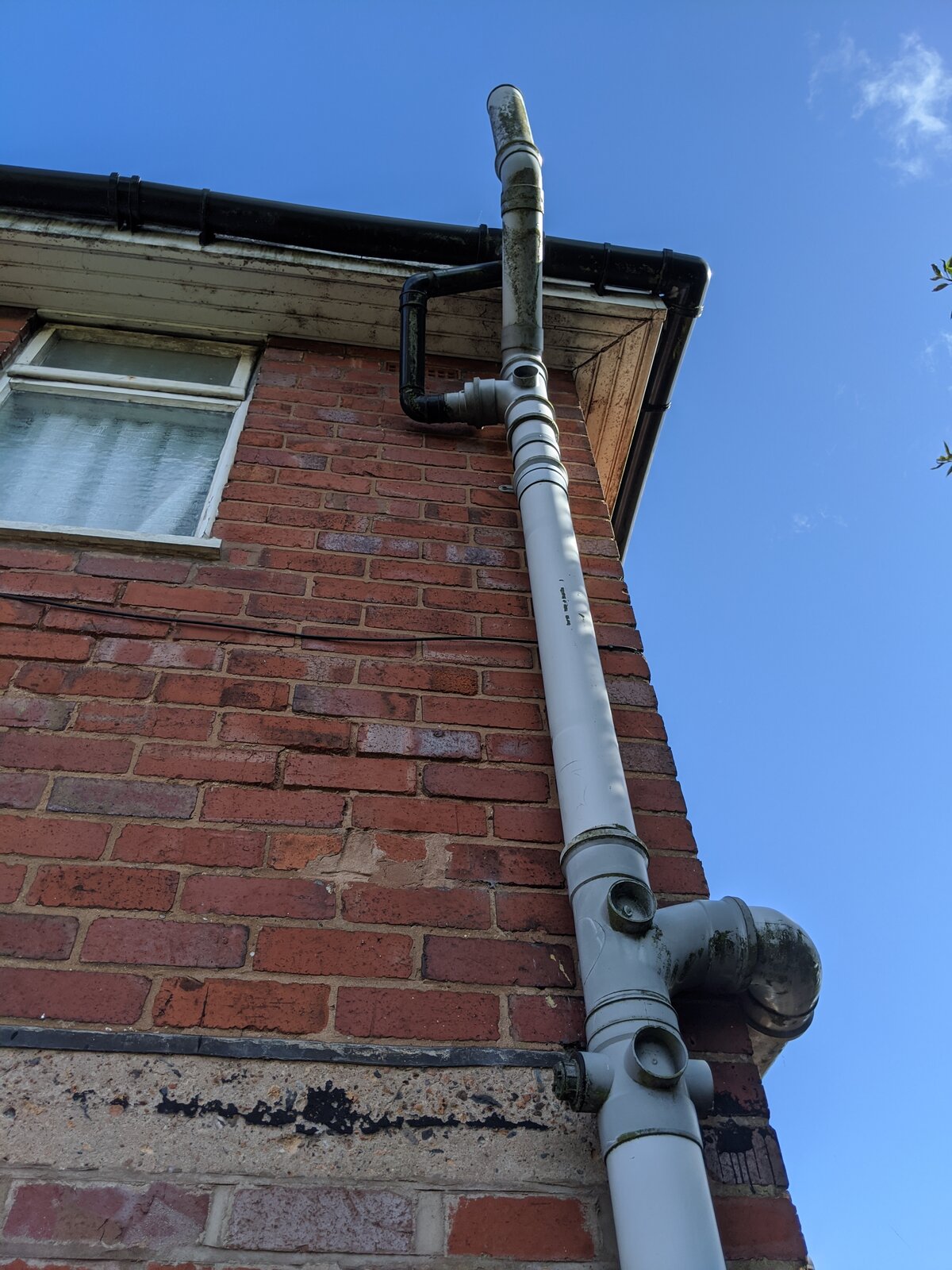

The man hole just serves our property. There are two inlets to the manhole. One from the down pipe (the toilet waste terminates into this too) and other from kitchen sink. So it's a mixed system.
Now I don't think I need to touch the manhole at all. I can probably just T into the pipe that comes from kitchen waste.

That's a bodge no rainwater would go into a soil stack
Anyway, despite what is there now, no new rainwater drainage should be going in to the drainage system.

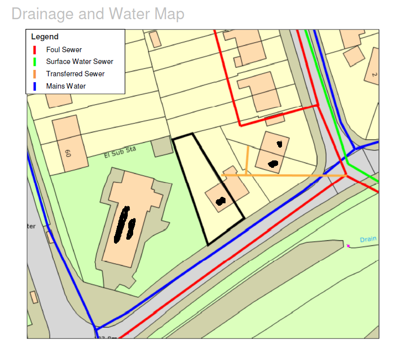

I found the drainage map from when we bought the house, what's a transferred drain?
Is it likely that there is a connection to the surface water drain from the property?
There is a surface water gully on the right hand side of the property, so could it be the case of bit of digging to find what that connects to? Is there any way of getting drainage maps at property level?

Section 60 of the Building Act specifically precludes the SW being connected into a vent pipe regardless of whether it has a separate or combined system. Long time since I've had to reference that one!!! Last time I had to implement it was pre 86 before the building act '85 came into force when it was covered under either the public health act '36 or '61, probably the '36 act but can't remember for sure
Looking at your property it may be old enough to have been on a combined system but you need to carry out a little more investigation
A transferred drain is a former private drain that is now the responsibility of the water Co as it serves more than one property, it may either be a combined sewer or foul water only sewer.
Building control may have the original plans, but drainage has a habit of being installed differently to the approved plans.
