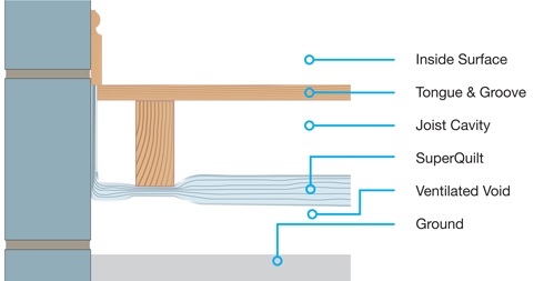

I am looking to insulate my front room via the crawl space under the suspended wooden floor.
I am torn between using standard loft insulation, or SuperQuilt. I see the SuperQuilt as being the easier install, but I am not sure on which would provide the best insulation.
As the width between the joists is only 28cm I would have to cut the wool several times per roll, where as I think the SuperQuilt can just be stapled straight across the joists?
This image is from the SuperQuilt website;
Any advice or tips would be appreciated.

I have since read that SuperQuilt and other foil options are over rated and not as good as some of the accreditation's suggest?
Also, foam boards are twice as good as rockwool.
Foam will be a better job, you could stuff it up, under the floorboards, hold it with a nail and foam any gaps and tape if you want to go the whole nine yards.
So if I went with board, does it need to be 100mm and above to get any real benefit? Then simply cut the board to size maybe leaving a few mm extra so it fits tight, hold it up with some galvanized nails and then foam and tape as required?
