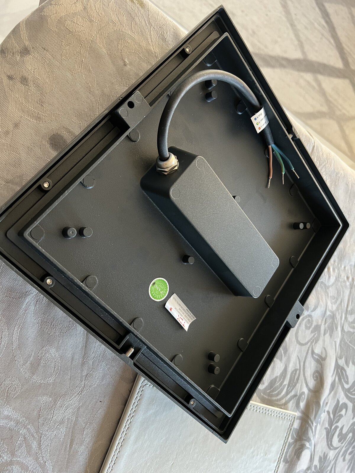

UPDATE - used the galvanised Y boxes with the SWA Glands. I’ve now got earth continuity all the way through. Thanks for your help with this.
I’ve used the outdoor SWA glands, outdoor stuffing gland where the cable goes off to each light and rubber gaskets under the lid for the conduit box. This all looks robust.
However, the light fitting - which is surface mounted - has a small length of cable that is factory fitted and I need to join my cable, coming out of conduit to this. Presumably I need to use wagos behind the light. I can try and put some silicone over where the light meets the brick but it definitely feels like a weak link.
Can you please advise. Thanks.
Here is a picture of the light. The Wago connectors will sit in the back of the light and inevitably come in contact with moisture
I was thinking that they will come in contact with water. All my other efforts to waterproof seem to be weakened by this.
The trick is to stop water getting in at the top, but to still ensure what water does find it's way in, can easily escape. No fitting is ever truly water tight - heating and cooling, creates a vacuum in the enclosure and that is enough to suck moisture inside. Seal the top and sides against ingress, but always drill some small holes in the bottom, for the escape of water.
