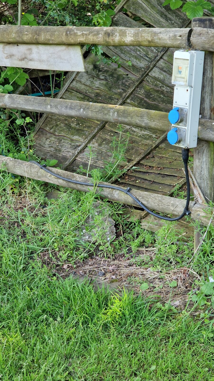

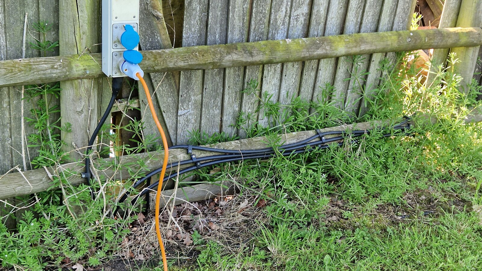

I was interested to see how this SWA was run to feed the supplies for caravans on a site I stayed on last week.
I wonder how many regulations have been breached?
Does it matter?
Of itself? No, it probably doesn't.
If that, and the state of the fence are taken as indicative of the general standards of workmanship, safety, site maintenance, etc. then perhaps it does.
it is a **** poor install and does not inspire confidence about work standards.
i always use the adage "what you can not see is often of a worse standard than what you can see, it is seldom any better or even the same standard"
