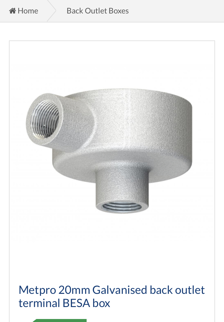

If running T&E and changing to SWA at an outside wall, this is my preferred method.
Sorry for blurred image!

I fit supplies to lots of Sheds / Garages , imo always best to have minimal joints in a Supply Cable , so for me it’s SWA all the way , at the Con Unit either gland it onto the Con Unit or terminate into a Wiska or Metal box & carry the Cable through to the Con Unit

As others have said, it is best to avoid joints if possible, so a continuous cable from the CU to shed would be the best option. However, SWA cable can be a bit of a pain to run through joists and restricted space if there is a long run inside the house. So it is perfectly acceptable to run the correct size T&E inside the house joining to SWA in a box. If you have the box inside, the bend radius when you go through the wall and down to the ground can look a bit rough. Far better to come into the back of a wiska box on the outside, then straight down with the SWA.
