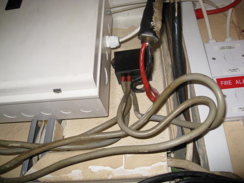

SWA
I would quess it is the customers , this is first floor of a pub, and I
assumed the swa was the supply up from the celler.
There is another small board on the end of the other tails not shown.
The M/Gerin board looked new, so I was intriqued why they
had left it like that.
Maybe I'm wrong and it is an outgoing supply.
I reported it for further investigation, I was there for another unrelated job.
Nothing suprises me now you've mentioned it's a pub.
I don't know why, but they almost always have completely botched wiring.
Maybe the breweries / owners saving money and getting the cheapest sparks they can?
I worked on pub fitting for a couple of years, and found nothing but garbage.
The worrying thing is they proberly work for our company.
A lot are subby's though.
Looks like a temporary bodge left for the forseeable.....
The paint indicates it was once fixed against a wall by the looks of it, and possibly correctly terminated and enclosed at that time.
