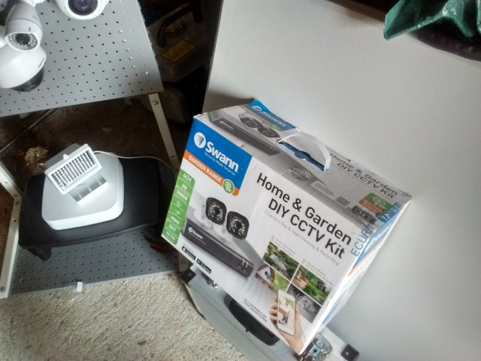

I went in 2 Maplin stores just before they closed their doors and bought these kits jepg attached (12 of them) for £30 each just for the DVR and the HD, these cameras are very basic and I would only install them in the dogs kennel....but there must be someone out here that had them for awhile and thinks their good.
